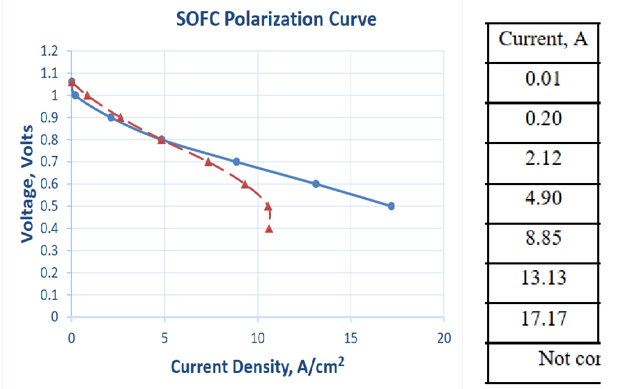

SubscriberHello, I'm wanted to do the post-processing for sofc. The post-processing I use is as following:
The current strength of the electrolyte surface can be calculated with these settings
Report Type = Integral
Field Variable = User Defined Memory ... => Interface Current Density
Surfaces = electrolyte surfaceÂ
However, I don't know if its A or A/cm2. When I generate the result,Â
[(A/m^2)(m^2)].
But, all other tutorial that I exactly give different answer as A and A/cm2.
Which is one is true? Because this will signifacantly determine my power output
February 24, 2023 at 12:49 pm
Murari Iyengar
Ansys EmployeeHi, the Current Density units are A/cm2.Â
