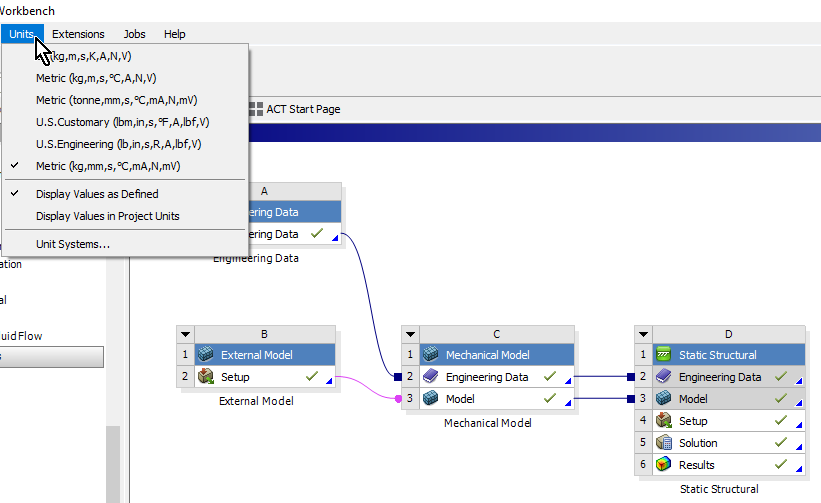

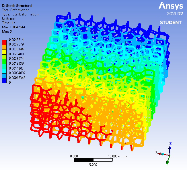

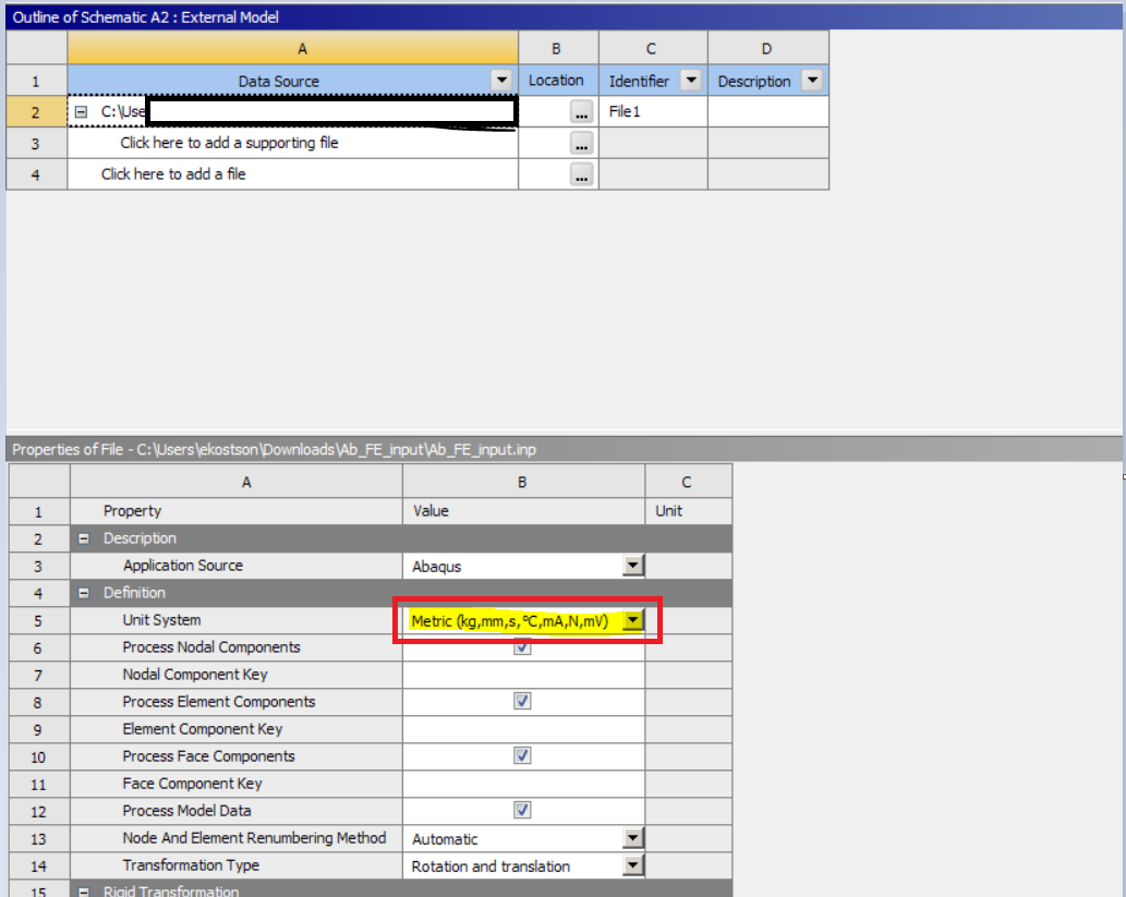

i met an error in ANSYS. As i exported an .inp file from nTopology software and imported it to ANSYS in a statical structural, the model unit turned out to be quite different. In nTopology it's 30mm and in ANSYS it's 30000mm and i found no way to change.
So did anyone else ever meet this error before and how can it be solved?

SubscriberAh, that really helps a lot! Thank you very much!
