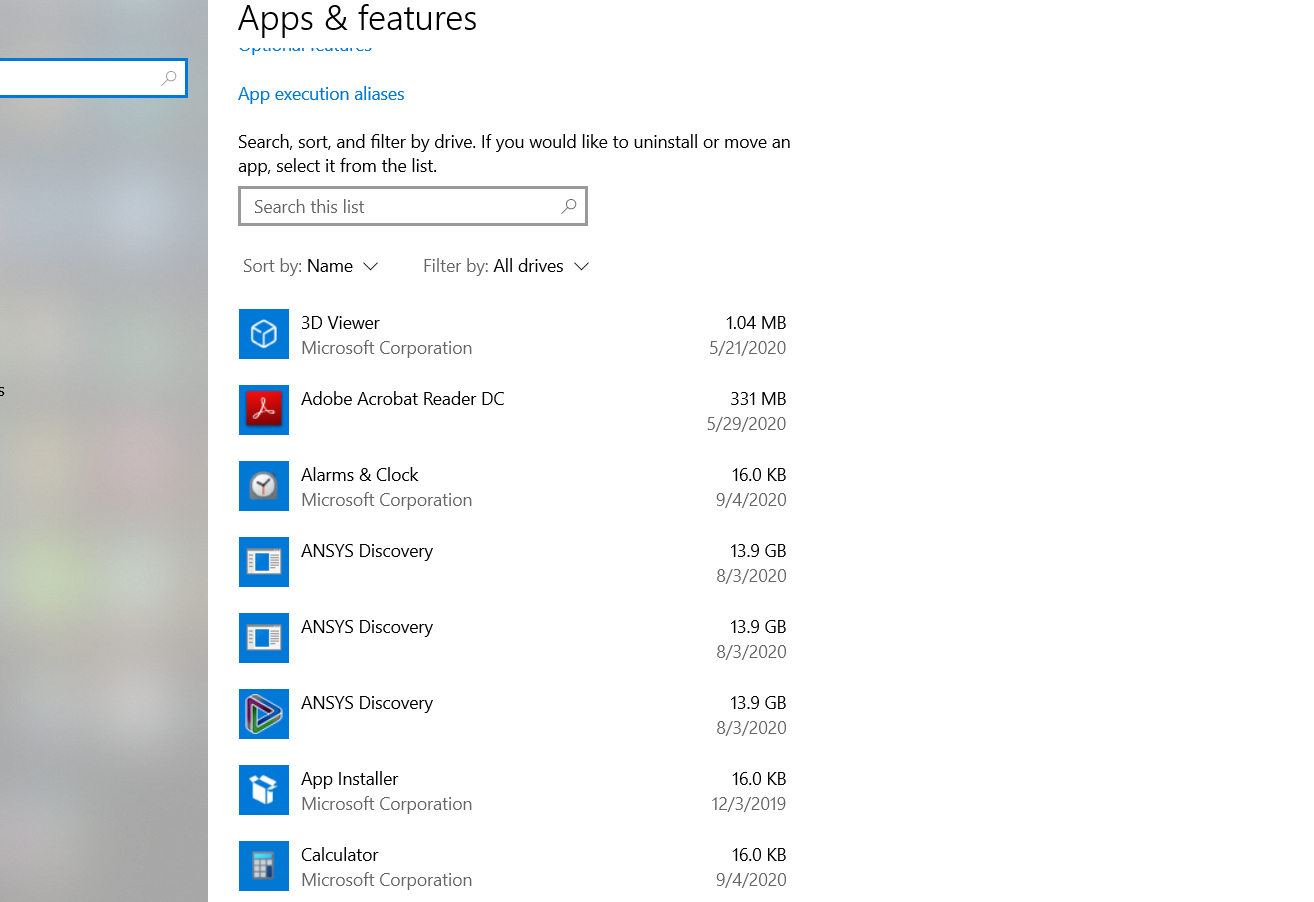

      Hi, just notice after uninstall still exist the icon and name. how to completely remove the software?
    • Naresh Patre
      Hello jinson
      Did you uninstall only SpaceClaim or all Discovery products? Were there any errors during uninstallation? The image you shared is showing Ansys Discovery size as 13.9GB so I doubt if Ansys Discovery was completely uninstalled. Can you try uninstalling it again if it wasn't successful earlier?
      If the uninstallation was successful, then you can delete the folder located with the installation drive to remove all the installation files.
