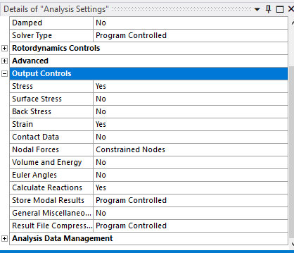

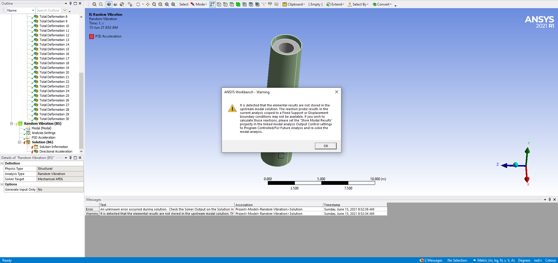

      I performed random vibration analysis after modal analysis, but Ansys shows me this error; I have no idea what caused this error. I have also checked that in the control settings of Modal, it is already 'Programmed controlled' for storing modal results. Any help??

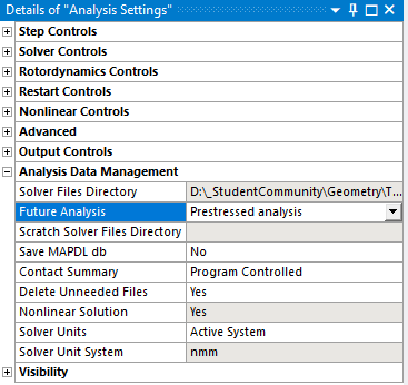

      Open the Static Structural model that the Modal is linked to and set the Future Analysis setting as shown below. Solve the Static Structural model, then Solve the Modal analysis then solve the Random Vibration analysis.

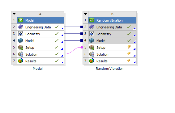

      I am only performing the modal analysis (to get the natural frequency of my model) for the random vibration; see image below.

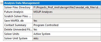

      I have attached the settings my modal analysis has. What should I tweak to get my job done?
