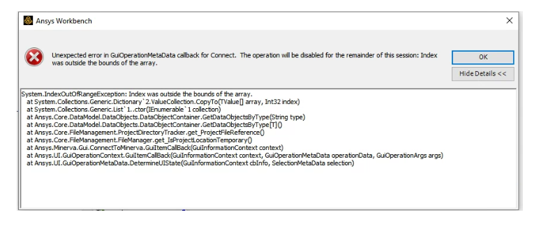

George Karnos
Ansys EmployeeExit all ANSYS Programs.
Rename %APPDATA%\Ansys\v### to v###.old where v### is the version you are running.
Now, try again.
