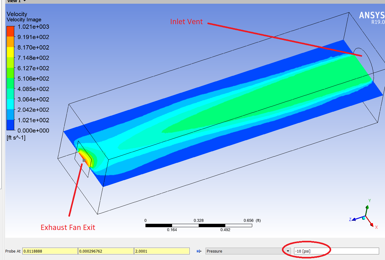

SubscriberI need to simulate cooling an electronics assembly using Fluent. There will be a fan on the outside of the enclosure drawing air out of it. The inlet is just a louvered area. I need to know how large this louvered are needs to be in order to allow the fan to run at maximum flow rate. I have a fan curve, but when I enter the fan info into the pressure jump box, my solution results always have extremely high velocities, almost an order of magnitude larger than what the fan can do at the given pressure. What am I doing wrong here? I need to have the fan velocity kept in check by the iterated pressure head it is seeing based on the calculations for losses through the inlet louvers. Right now it just jumps to max pressure head, and the corresponding velocity through the fan is extremely high.
My pressure jump parameters using piecewise linear are:
1) 0ft/s @ 10psi
2) 5ft/s @ 5psi
3) 10ft/s @ 0psi
My results are shown below when probed at the exhaust fan outlet:

Forum ModeratorCheck the result in Fluent, and plot the velocity with node values off. That way we can check if it's a true or interpolated maximum. Also check the panel sees psi etc or Pascals: some of the Fluent models assume SI units. Finally, I'm not sure how zero is seen in the solver, set the 0 psi value as 0.001 psi and repeat.

SubscriberI have re-run the simulation with the following scenarios:
1) Imperial units with .001 in place of zero
2) SI units (converted from imperial and manually entered), with zeros in place
3) SI units (converted from imperial and manually entered), with .001 in place of zero
All three of these produced the same results, which is that my fan velocity exceeds what my pressure jump curve should allow by greater than an order of magnitude. After switching back to imperial units for simplicity of my data, I unchecked node values, and the results still show 3,400ft/s velocity, where my fan curve limit is 10ft/s at zero psi.
