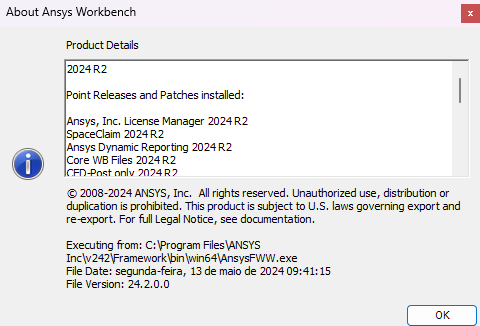

    • martinazzo
      I am using Windows 11 Pro 23H2.
      I could not find which Service Pack version is installed, but I believe it's not the latest since the File Date indicated in the "About Ansys Workbench" is 13 of may of 2024:

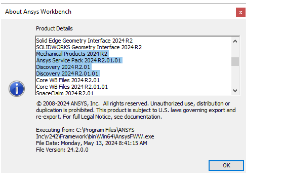

    • Gary_S
      Scroll down a bit and you will see any SPs. My example below is SP2.
