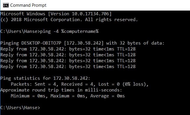

April 17, 2019 at 2:59 pm
JakeC
Ansys EmployeeHi Markh,
When connected to the school's vpn, please open a command prompt and type the following:
ping -4 %computername%
And post a screenshot of the result.
Thank you,
Jake

JakeC
This was when you were connected to the VPN correct?
If so, could you also post the result (while connected to the vpn) of:
ipconfig /all
Thank you,
Jake
April 17, 2019 at 4:22 pm
April 17, 2019 at 4:36 pm
JakeC
Ansys EmployeePlease open notepad as administrator.
Then edit the following file:
c:windowssystem32driversetchosts
At the bottom of that file add:
141.219.228.168 DESKTOP-OBITO7PÂ
(please I am not able to tell if the host name is correct on that line (with the O and or 0), so please adjust it to be your correct hostname)
Then retry the application.
Thank you,
Jake

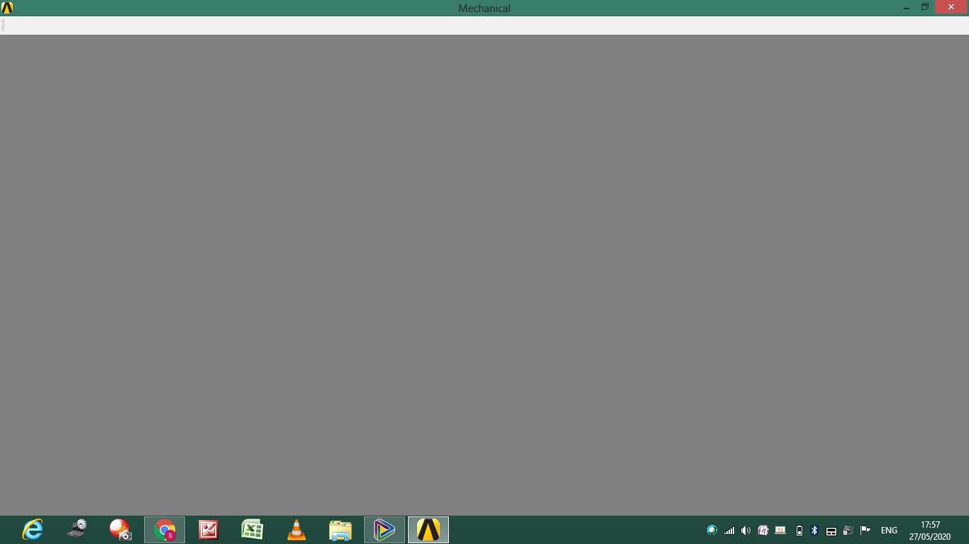

May 28, 2020 at 7:15 pm
tsiriaks
Ansys EmployeeManually register the DLLs listed below by starting a Command Prompt (DOS) with "run as administrator" , then typing:
regsvr32.exe ole32.dll
regsvr32.exe atl.dll
regsvr32.exe oleaut32.dll
regsvr32.exe scrrun.dll
regsvr32.exe jscript.dll
regsvr32.exe vbscript.dll
make sure they all say succeed
Now open regular CMD Prompt, and type the following command
move "%appdata%ansys" "%appdata%ansys.old"
