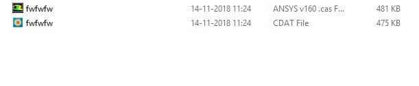

      fyoi
      These are the files which I have exported during solution. Still, it is unable to read the data except for velocity contours. But I can visualize the contours in the fluent solution itself after completion of the calculations.

      Which quantities did you select while exporting into cdat?
      Please select required quantities for export and then check if they come in CFD Post.

      You need to select the desired variables while exporting to CFD-POSt.  Fluent does not import the derived quantities by default.
