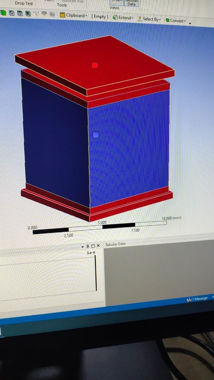

      I am doing LS dyna analysis of simple cubic structure with a top plate with velocity 1000 mm/sec and bottom fixed.
      Analysis was performed well.
      Now I want to do density based topology optimization. For this when I am setting Objective then in response constraint I am unable to set up response . Kindly help. Image is attached below. Thanks

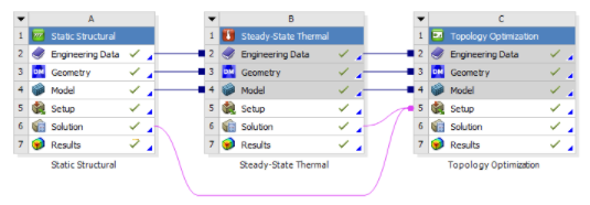

      Read the ANSYS Help and you will find this helpful information:
      Prerequisites and Requirements
      The Topology Optimization analysis must be linked to (preceded by) a:
      Static Structural
      Modal
      Steady-State Thermal
      Static Structuralin combination with either aModalor aSteady-State Thermal
      The loading and/or boundary conditions defined in your upstream system are used to create an optimized part based on the objectives and constraints specified in theTopology Optimizationanalysis.
