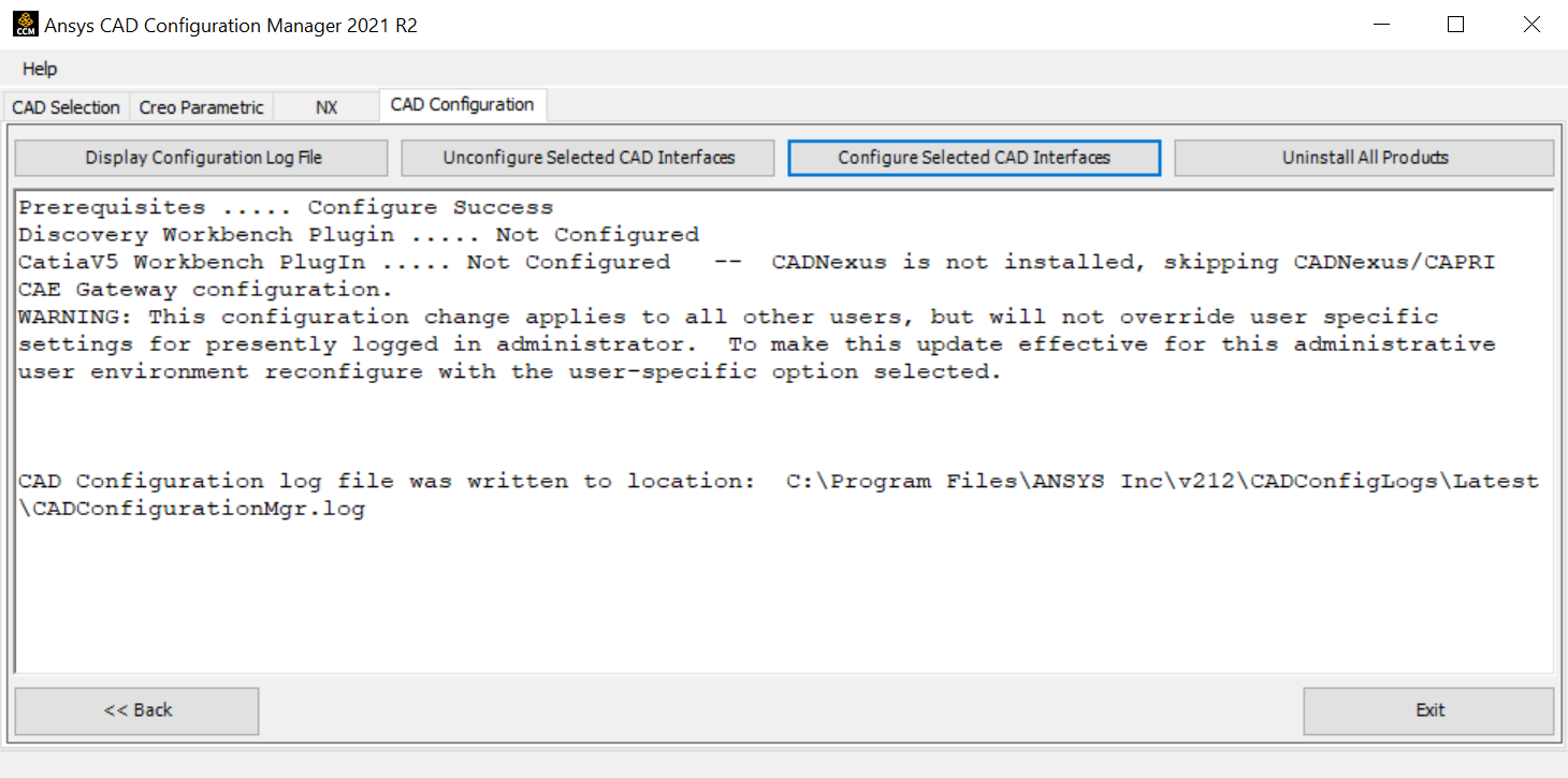

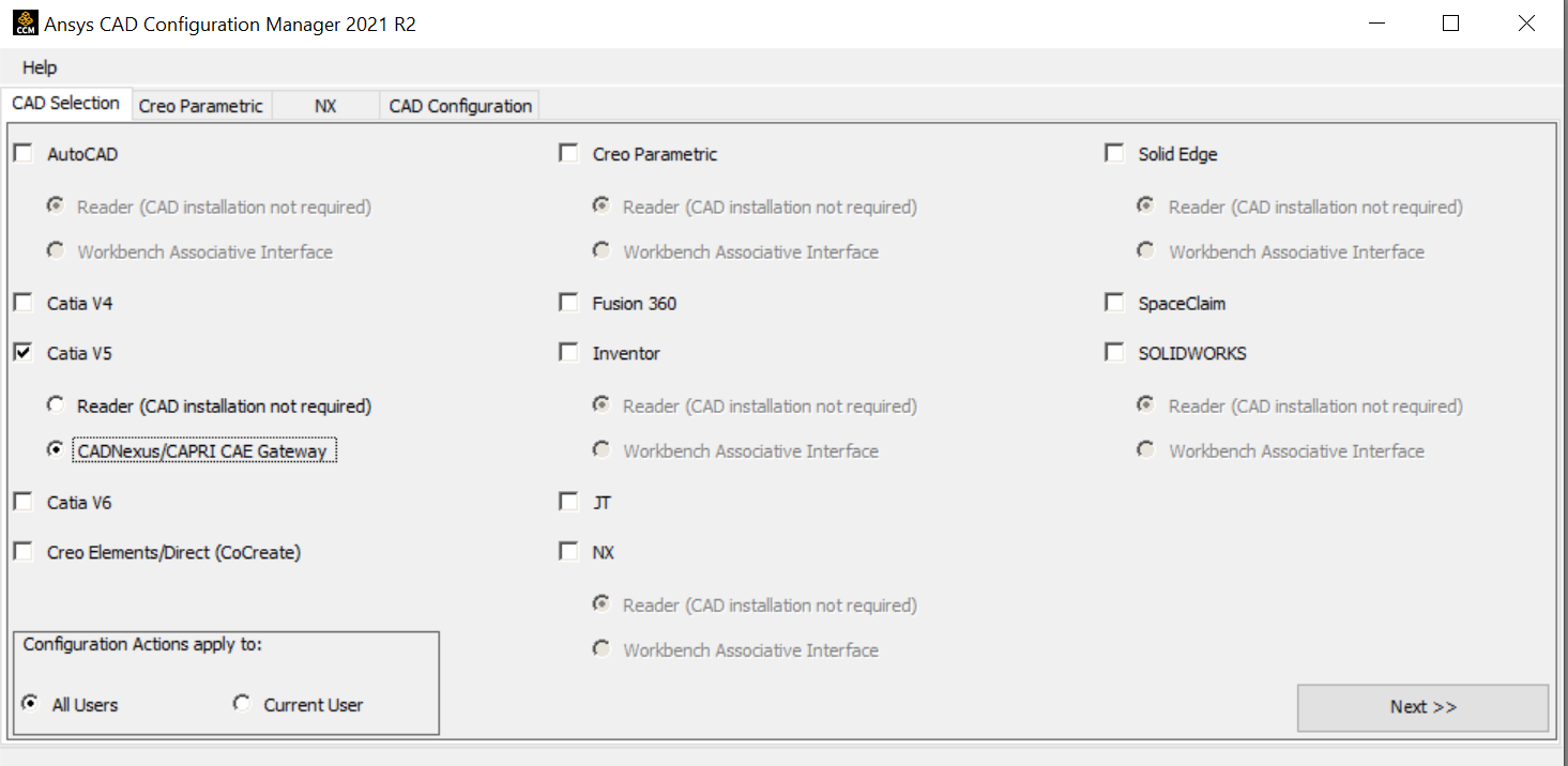

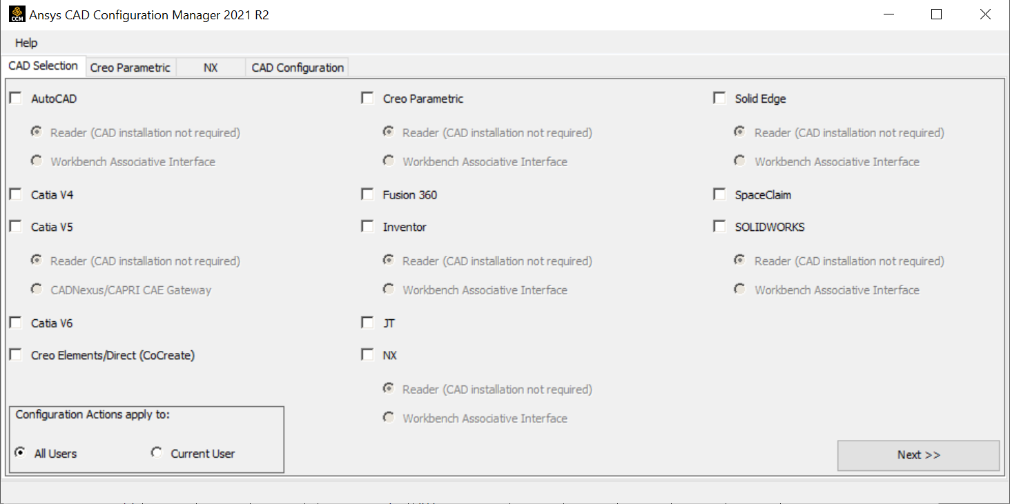

    • cfdasdf
      This is the config when I open the CAD Config Manager
      Is this the required setting in order to be able to open .CATParts?:
      If I try to configure it this way, the Plugin can't be installed...:
