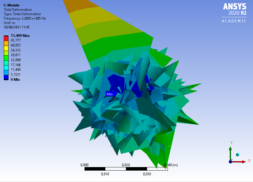

SubscriberI am studying a simplified transducer with only the piezoelectric ceramic and the coupling module on top. The voltage applied is a slot signal that goes from -100V to 100V at a frequency of 200kHz (which is supposed to be the driving frequency).

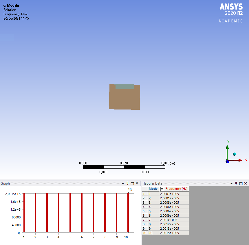

I will first launch modal analysis to then visualise total deformations for different resonance modes, but the results I get don't make much sense : the piezo is absolutely not deformed and the coupling module seem to be too deformed.
This the result for one of the modes, when I create them from the results of the modal analysis, which are here :

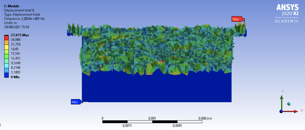

When I add the backing module around this first part the results are even worse :
The proportions of the deformation are simply impossible.

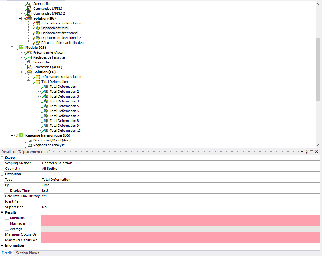

As for the Static and transient structural analysis I get this issue :
I am supposed to input values in the places highlighted in red but I cannot input anything.
I also get a warning because I am using multiple dimension analysis even if all the analysis are set on the same dimension setting.

Ansys EmployeeHi
Just run a full harmonic response no need for modal - the results you see are strange because the nonpiezo material is softer so it behaves funny like this.
So just run the full harmonic response and excite your piezo - plot the displacements and deformation of the piezo only (so scope results to that part only) and see that it behaves as expected.
Erik
June 30, 2021 at 1:10 pmMCK_Pandaleon
SubscriberThis does work , but I still have an issue with the command of the transient and static structural analysis.
I want to impose a slot voltage that varies from +100V to -100V at a frequency of 200kHz. How do I do this?
The electrodes are named selections (positive and negative), I thought of putting a time frequency table in place but I haven't managed to do so. Therefore, the simulation doesn't work well.
June 30, 2021 at 1:18 pmErKo
Ansys EmployeeThat is good - piezo are normally done in freq. domain using harmonic response.
For static use just d,exc,volt,100, and for transient, use a table called for instance voltexcite shown below (that varies with time) instead of a constant:
like this:
