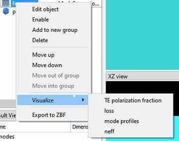

SubscriberHi Amrita

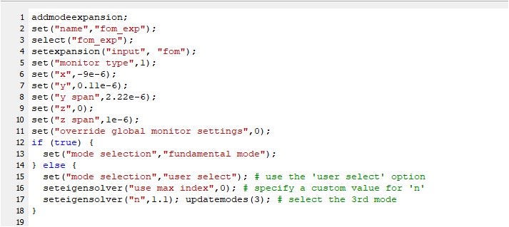

Thank you so much for your reply. I actually cannot find it from the GUI. Indeed, I cannot find it in the official file either. (The official file can be accessed via https://optics.ansys.com/hc/en-us/articles/360042800573-Inverse-Design-of-Grating-Coupler-2D-). Below is the screenshot of the mode monitor from the official file, there is no expansion for fom.
What I have done: first I added the description below under the model and then I can add this result into sweep manually and the result is fine.
temp = getresult("fom_exp", "expansion for fom");
T = -temp.T_backward;

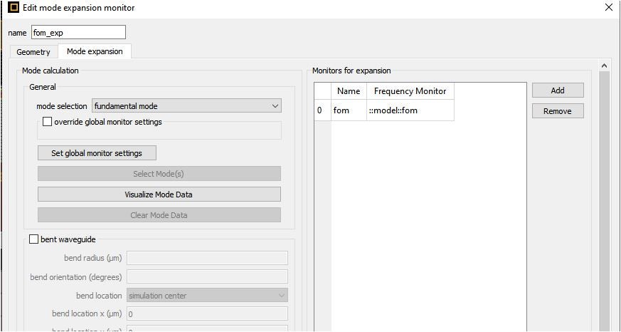

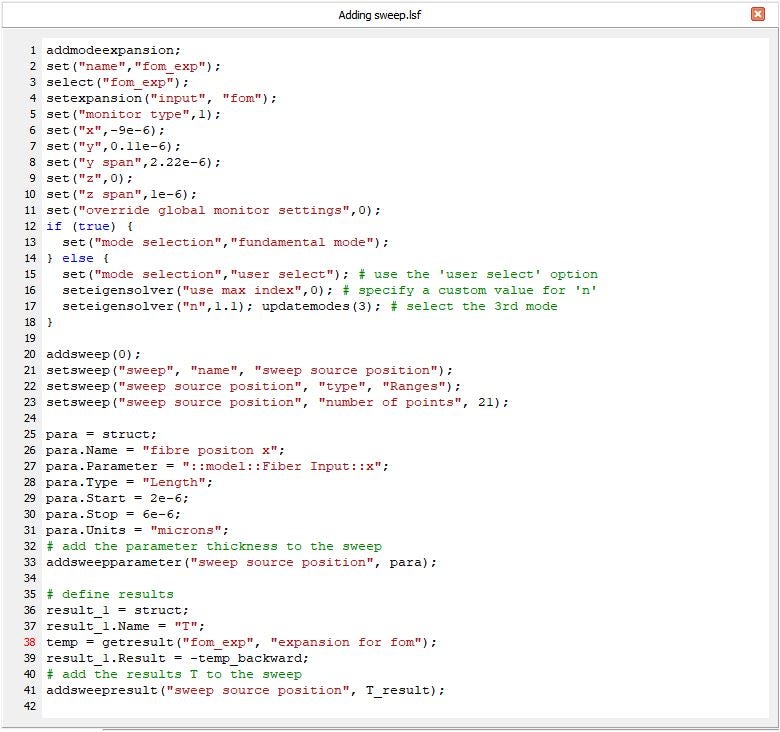

So it seems that the results do exist and can be used for the sweep. But again it does not show in the GUI. From my lsf, I have linked the " fom " monitor to this mode expansion monitor. Below is the screenshot of my lsf and the setting inside the mode expansion monitor.
I reckon it will automatically generate the expansion for fom. Or are there any settings I should pay attention to?

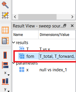

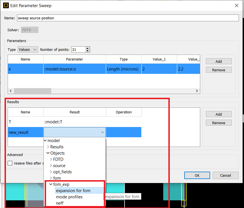

Thank you for providing more information. Correct me if I am wrong, my understanding is that you want to obtain the “expansion for fom” results for all sweep parameters after the sweep is completed. In that case you will have to record this result during the parameter sweep as shown below or using the addsweepresult script command:
Then you can use getsweepresult script command to get these results. It should also show up in the GUI in results. Please let me know if you have more questions.

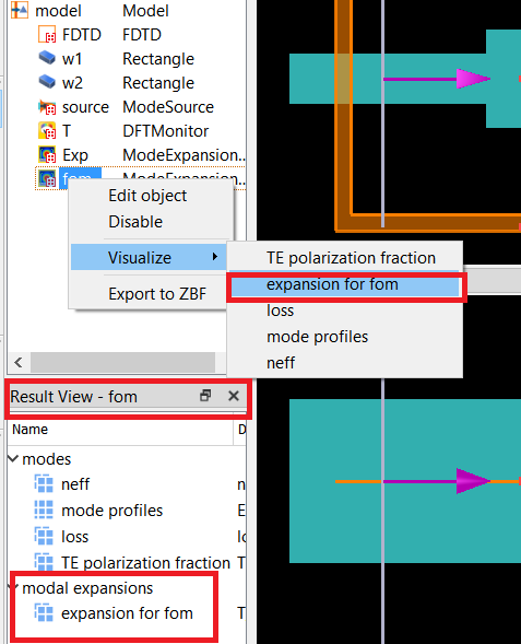

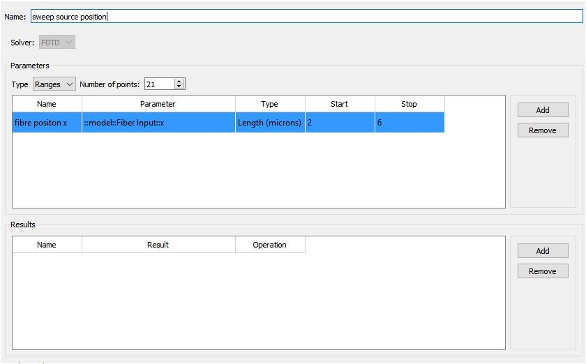

Thank you for your reply. I totally agree with you that I need to add the result into the sweep setting. However, my problem is that I cannot find this result in the first place.
In the official file, they define the parameter T under the model analysis, and T is defined as below:
And my understanding is that the result is from fom_exp : expansion for fom.
And here comes my issue: there is no expansion for fom underneath the fom_exp. Therefore I cannot add it into the sweep result because it will keep giving me error like this:
But I cannot find out where to set up the expansion for fom. As you mentioned before, there is actually no such a term in my GUI. Funny thing is that if I followed the setting in the official file, which is defined T in model analysis and used exactly the same code shown above, it worked. Lumerical will find out the expansion for fom and get T.
To conclude it, I cannot access the results from expansion for fom via normal lsf code because it will give me an error that cannot find the result expansion for fom. But if I manually define T in the model analysis, it will work. To make it clearer, my problem should be how can I obtain expansion for fom monitor in mode expansion monitor like in your screenshot? I reckon if I can see it in the GUI then I can access it via normal code.

Ansys EmployeeHi Peng,

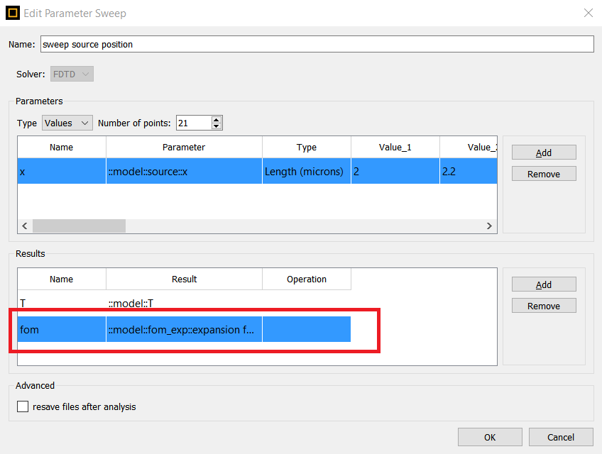

Thank you for sharing more information. That is unusal. You should be able to add the expansion for fom (to the sweep result) result using the addsweepresult script command. Once you add it and run the sweep then you will see it in the GUI Results. I was able to do so in the same file from the article you mentioned above. What happens when you use the addsweepresult command? Do you also get the same error? In the first screenshot that you shared, you were using getresult which resulted in the error message.You have to use addsweepresult.
You can also do it manually in the Edit Parameter Sweep window? Can you find it in the Parameter Sweep window as shown below?

If you wish to do it by script, in your file adding sweep.lsf, I would suggest you to replace Line 36 to 41 by the following code and then run the script:sweep_result = struct;
sweep_result.Name = “fom”;
sweep_result.Result = “::model::fom_exp::expansion for fom”;
addsweepresult(“sweep source position”,sweep_result);
runsweep(“sweep source position”);
result = getsweepresult(“sweep source position”,”fom”);
T = result.T_backward;Please let me know what happens when you do this. Thank you!

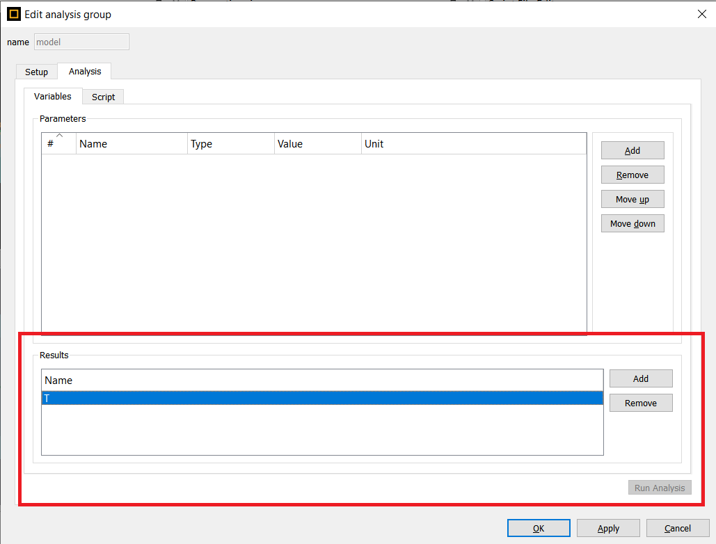

I assume you wanted Line iv. to be iv. result_1.Result = -temp.T_backward; As temp_backward variable is never used before in your code and as a result you get the error. However, even making the above code change would result in an error. Since in addsweepresult you can only add the monitor results that are available, which include the following:
For including any other result you have to output this result from the model (or Structure/Analysis group) like it was done in the original file in the Analysis-Variables Tab of model:
If you want to do it in .lsf file and not use the model, I would suggest you to record the complete set of results from “expansion for fom” and access the T_backward result with the negative sign using the code I have provided. Hope that helps.
