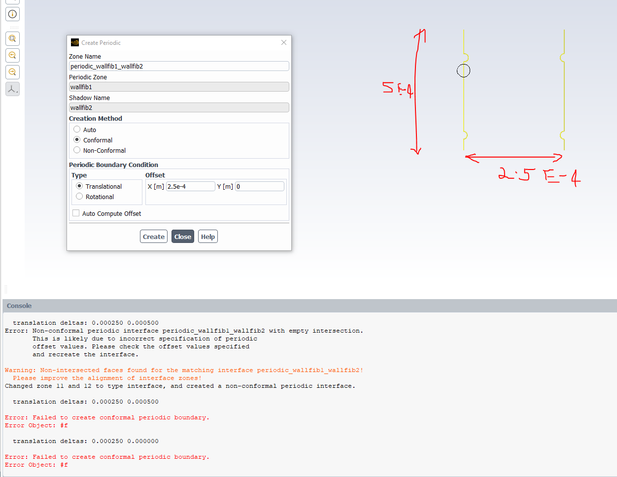

      Why does ansys fluent not allow me to create conformal periodic boundary conditions in this model
    • Keyur Kanade
      Because the geometry is not topologically periodic.
      Please make sure that geometry is periodic.
