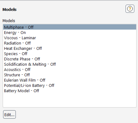

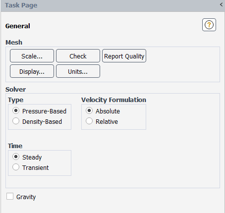

      Adding the variables means the data is saved into the .dat file, not that anything extra is calculated. Have you turned the Energy equation on?
    • Tensionmember
      Energy Equation is turned on, yes.
      I uploaded the Model so that you can see my current settings.
      Unfortunately I cannot display the results using contours, none of the added variables are displayed in the results window. Additionally, I can only select the additional data quantities in the "Run Calculation" screen of Fluent, in the top left tab under "file" they are grayed out, even after the calculation has been initialized.
      Thanks in Advance
