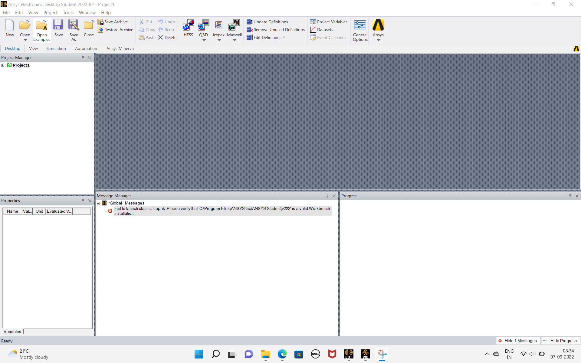

      I am Unable to access "classic icepack" in Ansys electronics desktop student 2022.
      Its giving error as "Fail to launch classic Icepak. Please verify that 'C:\Program Files\ANSYS Inc\ANSYS Student\v222' is a valid Workbench installation."
      I am attaching error picture with this.Error image
      Please help me out to resolve this.

      Hi Dileep, Please note that student versions do not support Workbench tool integration. This feature is only supported in regurlar version. Kindly use the regular version for this. Best regards, Praneeth.
    • vganore
      We do not offer Classic Icepak in any student products. The classic version is available in teaching and research products only. If possible, please use the regular Icepak version available in electronics student product.
