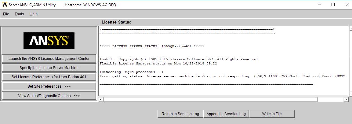

      I am working at a university lab where we have the license (renewed in February 2018)  for the Ansys Academic Research HF programs on our lab desktop. I was using the Ansys Electronics Desktop for the past 2 months and the program was working perfectly fine. A few days ago, I wanted to try the Ansys Simplorer program and so I closed the Ansys Electronics Desktop and went to the Simplorer program. For some reason, it gave me an error stating something about gui and maybe license. I don't remember what that error was but I remember there were some features that were grayed out so I assumed maybe our license didn't cover those features. Afterwards, I wanted to go back to the Ansys Electronics Desktop and continue my work on there, and so I closed the Simplorer program. However, when I went back to the Ansys Electronics Desktop program, it wouldn't even open up. I closed the related programs on the task manager to ensure I didn't have 2 Ansys programs running at the same time (bc I know that can cause issues too). The Ansys Electronics Desktop program still isn't opening up and I am not sure why considering the fact that I was able to use it for the past 2 months. I have attached pictures of the errors I am seeing. I would appreciate potential solutions. I did see some suggestions about changing the port number, but I couldn't locate the license.dat files and I didn't want to make that change without getting assistance/feedback from someone more technically verse with the program.
      Thank You

      Hi hgar96 ,
      I would check with the license server admin to see if there is any change on the license server (like restart the License Manager, install new license files, etc.).
      Please post the the following information from your machine
      1. All .lic files under (by default) C:Program FilesAnsysEMadmin
      2. Output of the command
      set > set.log
      in the CMD Prompt
      Thank you,
      Win
    • hgar96
      Thank you for the feedback. I restarted the computer, and the HFSS program is working now. However, when I'm trying to use Simplorer, it is showing the error below. Our lab has the license for "Ansys Academic Research HF". The other tools seem to work, so could it be that we have access to all the tools but not Simplorer? I would assume Simplorer is included in the bundle. Please let me know if this can be fixed. Thank You
    • tsiriaks
      Hi hgar96 ,
      On the license server machine, open up ANSYS License Management Center -> Display FlexNet License Status , then see if it has simplorer_gui license in the list. You could also copy and paste the entire output and post them here.
      Thank you,
      Win
    • hgar96
      Thanks. Below is the output. I don't see it on there so I guess we don't have it. So, if I don't see licenses for Maxwell or circuit design on that list,  would it mean that I shouldn't be able to use it as well? I didn't run any analysis on the circuit modeling tool, but I was able to open it and import an sNp file. Would I be blocked from particular features or is circuit design and Maxwell tools bundled under a different license? Thank you
