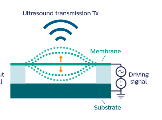

I am doing an acoustic simulation of Capacitive Micromachined Ultrasonic Transducer simulation.
Basic Structure of CMUT:
June 15, 2021 at 9:50 amErKo
Ansys EmployeeHello
You will only get pressure (bulk/acoustic) waves in the fluid (Lamb, are guided waves in plates, or Rayleigh surface waves on thick structure, or in plates if the frequency-plate thickness product is high enough).
So once the membrane oscillates it will generate acoustic waves in the fluid (excitation mode), or if the acoustic waves excite the memearne one will register a voltage (receiver mode)

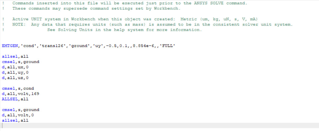

Did not say that, I said that I have not seen any examples of this - you might still be able to do what you want, but you would need to find out by trying yourself (so static dc bias followed by harmonic).
Also do you use solid226 for the internal airgap and to get the capacitive force on the membrane?
I would also say that the Lamb waves are mostly excited by the two support legs on either side of the membrane thus transferring the vibrations into the substrate.
All the best of luck -
let us know how it goes, and how you progress.

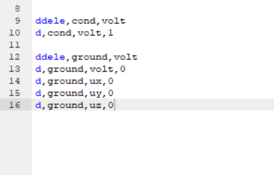

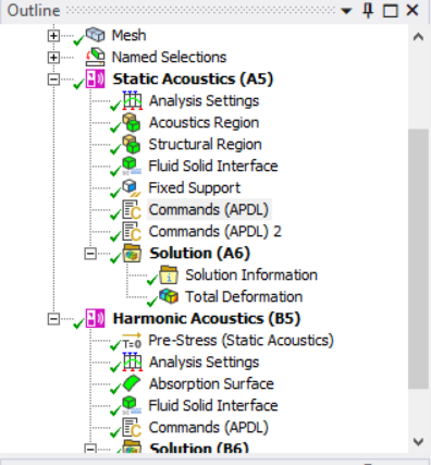

June 15, 2021 at 12:33 pmdardhruv
SubscriberHello Sir I have used the Trans126 element to do mesh for the vacuum gap between the Membrane and the Substrate.
Here I have attached a prestressed harmonic file.
I don't know, Is it ok if I also define substrate beneath trans126? to check the effect of the lamb wave I have to define substrate also. right?
Thanks and Regards Dhruvin
June 15, 2021 at 12:45 pmErKo
Ansys EmployeeUnfortunately we can not download this - put some inline images of the model. Also include some results
To answer your question, yes, you would need the substrate to check for Lamb waves and standing waves there - show a stress result (inline image), for the simulation at the driving freq. (1.8 MHz).

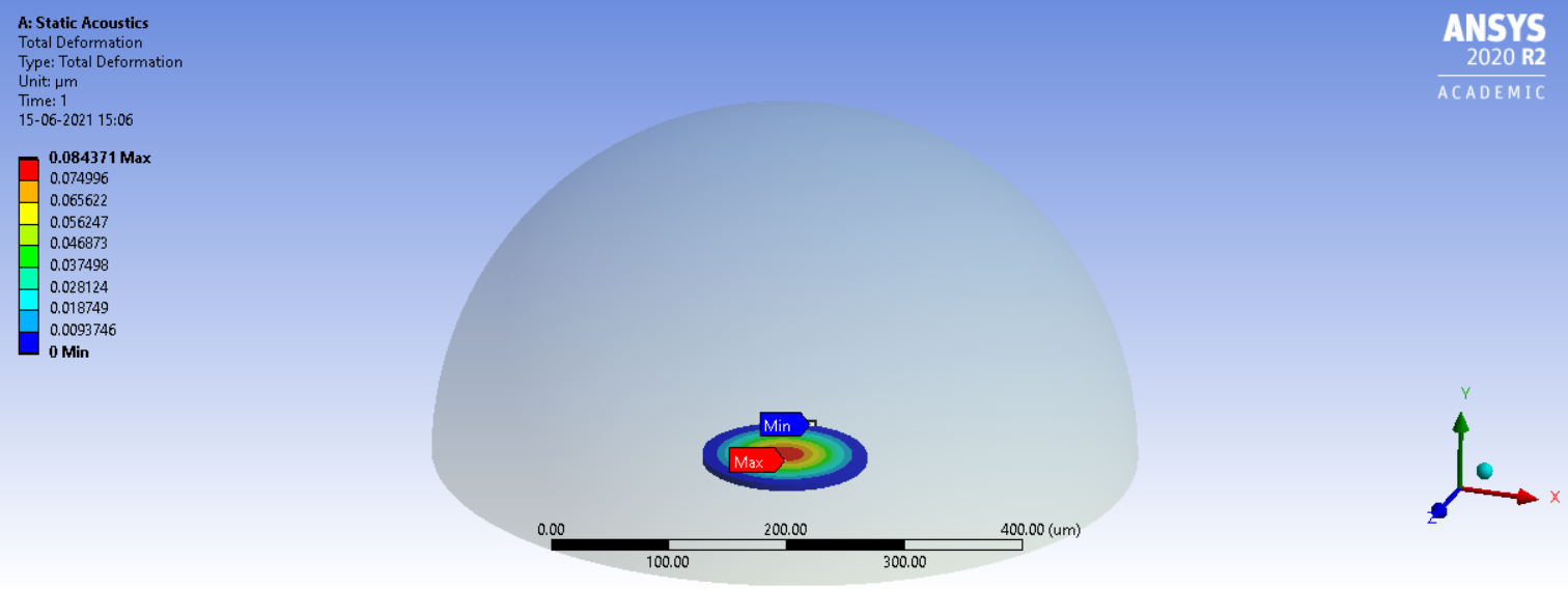

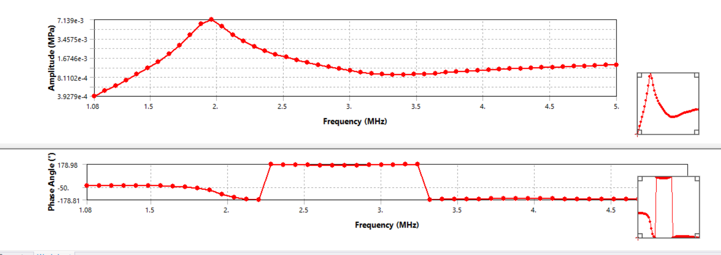

June 15, 2021 at 1:14 pmdardhruv
SubscriberHello Sir static analysis:
Harmonic Analysis:
pressure on top of membrane:
Please check this?
If I add substrate then it will not affect trans126?
I always thought if I have defined trans126 then why should I add substrate. But now I think I was wrong.
It should be there to check wave propagation on a substrate. right?
is there any example where trans126 and also bottom substrate present
Thanks
Dhruvin
June 15, 2021 at 1:17 pmErKo
Ansys EmployeeTHat looks sensible perhaps - you know if the resonance is ~ 2 MHz :) - suppose you measured it?
June 15, 2021 at 1:51 pmdardhruv
SubscriberHello Sir Yes, It's nearly 2 MHz.
