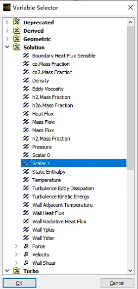

Forum ModeratorSwitch to save either .cdat with those fields added or Legacy format .dat.gz By default CFD Post takes a smaller subset of data to keep the files sizes manageable and/or because Fluent calculates some values when requested as opposed to storing them.
Note, other than a few animation functions Fluent's post processing is generally better than CFD Post. Even the transient data management is moving to Fluent.
January 19, 2026 at 10:30 am
James411project
Subscriber“Thank you for your reply. What I'm currently working on is related to turbomachinery calculations, and the Turbo mode in CFD-Post is more convenient for this.”
January 19, 2026 at 11:00 am
Rob
Forum ModeratorSure, so you'll need to add those fields to the .cdat or check the Legacy .dat.gz (UDMs will be included but not CFFs).
