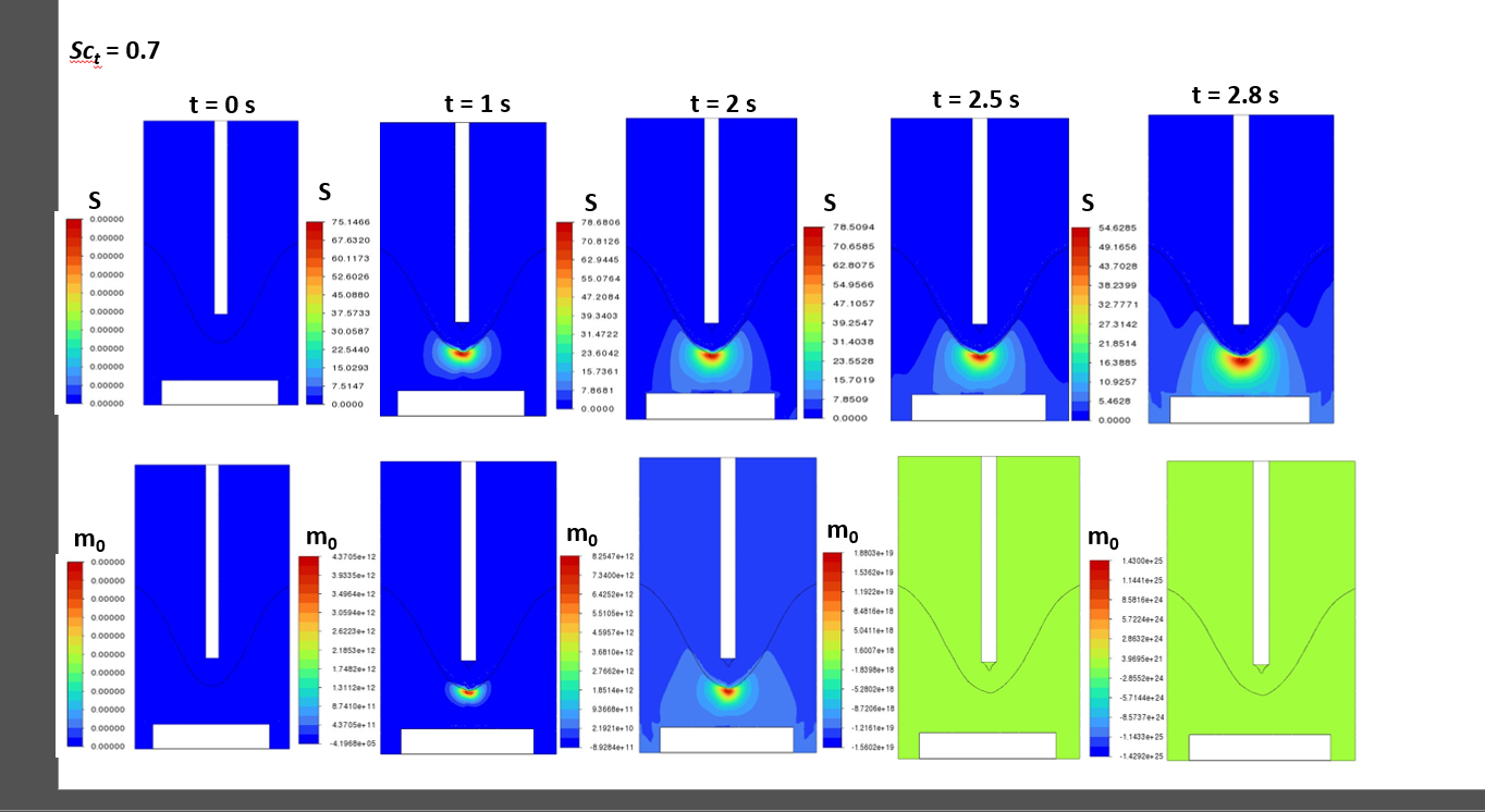

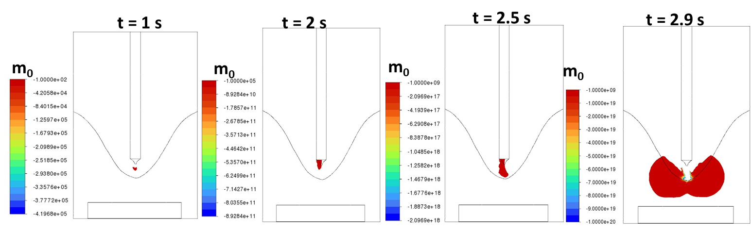

      Hi, thank you for the reply. I have plotted some contours of supersaturation (top) and zeroth moment (bottom) which represents the number density of particles. Essentially with a semi-batch process with slow feed and fast reaction we should see a segregated feed with localised region of high supersaturation near feed where nucleation is dominant and low supersaturation which slowly builds up in the bulk which is growth dominant. Nucleation and growth aren't activated until supersaturation driving force exists is (S > 1)
      What I am finding is that the m0 value is giving an unphysical value and you can see from the contours that after 2.5 s it just increases out of control and I'm really stuck as to how to control this. Another noticeable is there are negative m0 values, despite supersaturation and nucleation having a minimum value of 0. You mentioned applying a limiter, how would I do this?

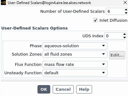

      Note: In the feed pipe only liquid should be coming out, all scalar fluxes at inlet B.C are set to zero. I have noticed that inlet diffusion is activated by default. Could this be contributing to simulation instability for semi-batch which has feed b.c as compared to batch which is a closed system.
      Inlet diffusion only matters if the flow is low enough that you can diffuse more material in than can flow. Turning it off may help. I assume all 6 scalars are set the same?

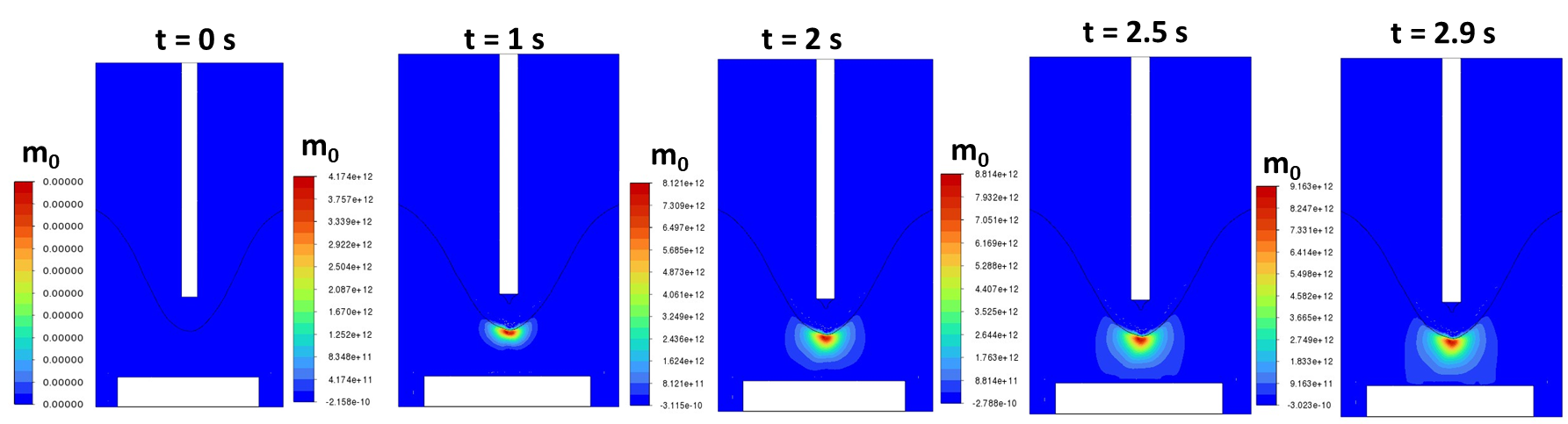

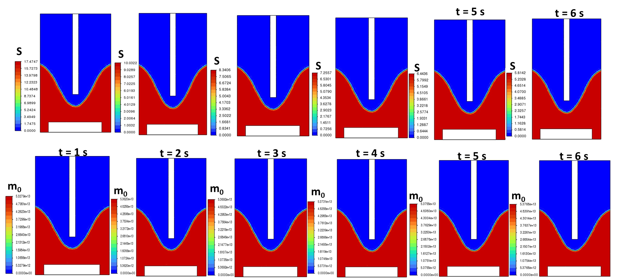

      Okay no worries, thank you for the advice. Interestingly I have also tried plotting my scalar quantity m0. There should be no feed for scalar coming from pipe (set to value of 0) as only liquid is discharged, but what I am observing over period of feed addition is plume develops for the scalar quantity and has a negative vale. This plume grows in size and magnitude reaching very large negative values which eventually disperse in the liquid. At the point it grows large in size and disperses in the liquid is when I lose control of my solution and get garbage values for crystal mass. Is this a strong indicator that inlet diffusion of UDS is causing this effect as I don't know how a negative feed plume is forming.
      That could also scalar convergence not being good. UDS don't have all of the extra stability functions that species etc have so they can be more sensitive to mesh, time step etc.
    • SR786

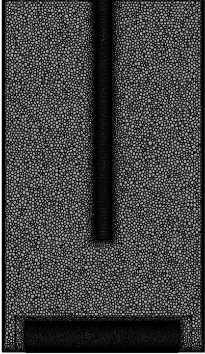

      No worries, I already have a refined mesh (see mesh cross section below) near the feed pipe using polyhedral mesh whoch is known to be better than tetrahedral for gradient calculations and I am tightly controlling time step with time step size of 5e-5 s (CFL = 0.55) and low URF for UDS with 0.2. My residuals for UDS actually do converge to < 10^-5 but the solution I get is garbage. That's sort of why I'm now leaning towards this inlet diffusion problem, especially after analysing contour.
      How is m0 negative in the first place?

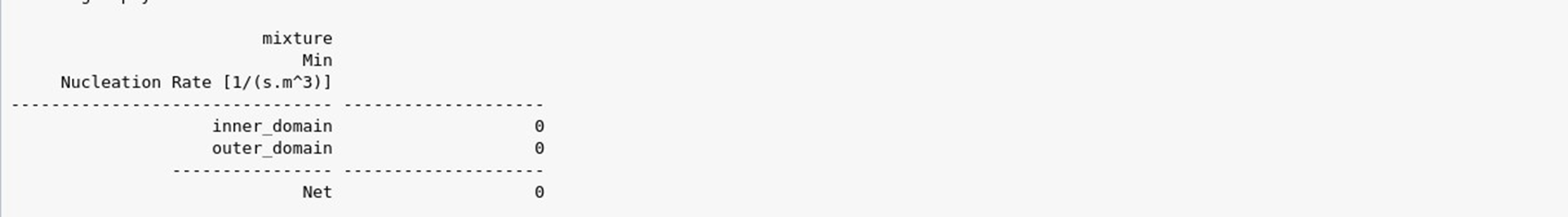

      I am not sure why m0 is giving a negative value as according to my solver set-up:
      At t = 0; m0 = 0.
      For t > 0: the solution becomes supersaturated (S > 1) from mixing with feed causing m0 to increase with nucleation rate as S_m0 = B and B = (S-1)^b. When S < 1, B is deactivated so B = 0 and therefore S_m0 = 0 so there cannot be a negative source term for m0.
      The first thing I checked was if Fluent was giving negative values for B as this would result in S_m0 < 0 and negative m0. I checked and the minimum value of B was 0.

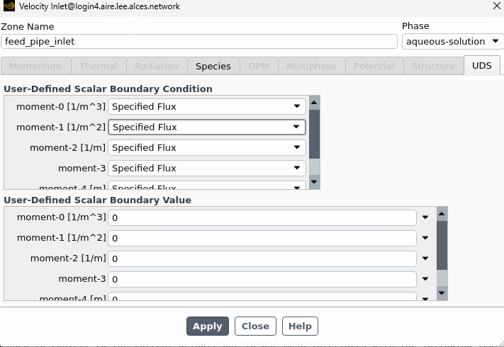

      All the scalar values at inlet B.C are set as 0 (under specified value condition). So the only other thing I can think of is that inlet diffusion was activated for my semi-batch simulation. For my batch simulation I did not observe negative moments likely because the system was closed and so I didn't have an inlet B.C.
      Which comes back to convergence. Are you using fixed value on the inlet, or fixed flux?
    • SR786
      I'm using the default settings which is specified flux. All the scalar boundary values are set to 0.
    • SR786
      Should I use specified flux or specified value for UDS at inlet?
      Depends what it's for! Might make sense to fix a zero value somewhere to anchor the UDS.

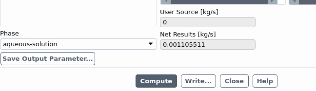

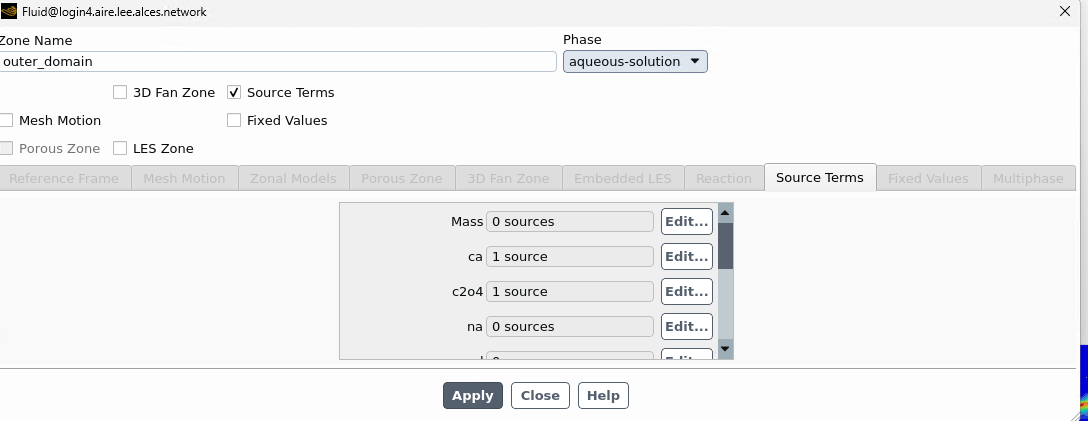

      I wanted to revist this point you made: 'OK. In Fluent if you add/remove species without a corresponding mass source you'll (probably) lose/gain the last species in the list to meet mass conservation.'
      So my source term is:
      S_i = +/- (3*m2*G*kv) *Mw_i/Mw_crystal
      My overall reaction is forming calcium oxalate monohydrate:
      Ca^(2+) + C2O4^(2-) + H2O ---> CaC2O4.H2O
      I only added two species terms, calcium and oxalate ion and not the precipitate nor water (last species). I assumed I didn't need them, but for my CFD-PBE solver it won't know where mass is going and it may not be conservative.
      Do I need to add another species for the CaC2O4.H2O and as water is the final species, I can only set its source term by setting total mass source to zero as:
      S_total = S_product - S_reactant = 0
      OK, so you're removing two "named" species plus water but not specifying where it's going? The complication is it's a mass sink/source as opposed to mole based. If you remove & add the three "named" species, the water should be added/removed based on the terms in the "named" sources: ie it'll balance.
      The problem is you're then using UDS to track the moments, and UDS are not necessarily linked and don't have a volume fraction limit etc.
    • SR786
      Yes, the UDS isn’t explicitly linked to species balance, so I need a pseudo-precipitate species in my species mixture model to make up lost mass. I believe this is what some key papers have done as well for CFD-PBE modelling where they treat flow as pseudo-homogeneous so they solve for single phase flow and implement PBE via UDS.

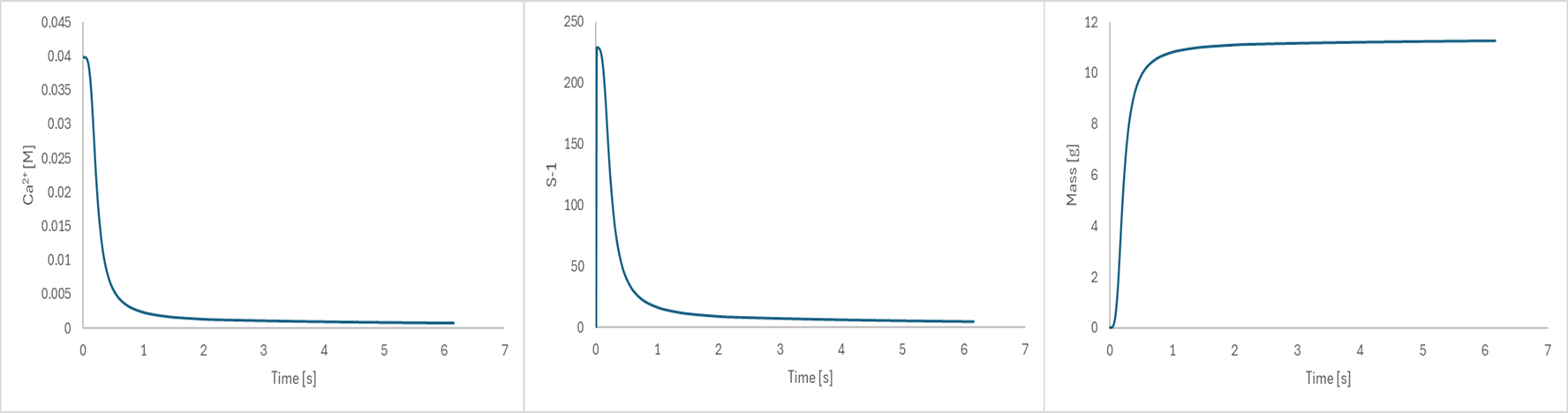

      I believe I have now resolved the issue of the unphysical crystal mass. The primary culprit appeared to be a wrong B.C set for inlet UDS, where I now use Dirilecht B.C with value of 0 for UDS. By correcting for this, now my UDS remain physical and my values do not explode. I will still also set S_total = 0, to keep mass balance conservative and avoid mass increase of last species (in my case the solvent water) to account for loss of mass from reactants
