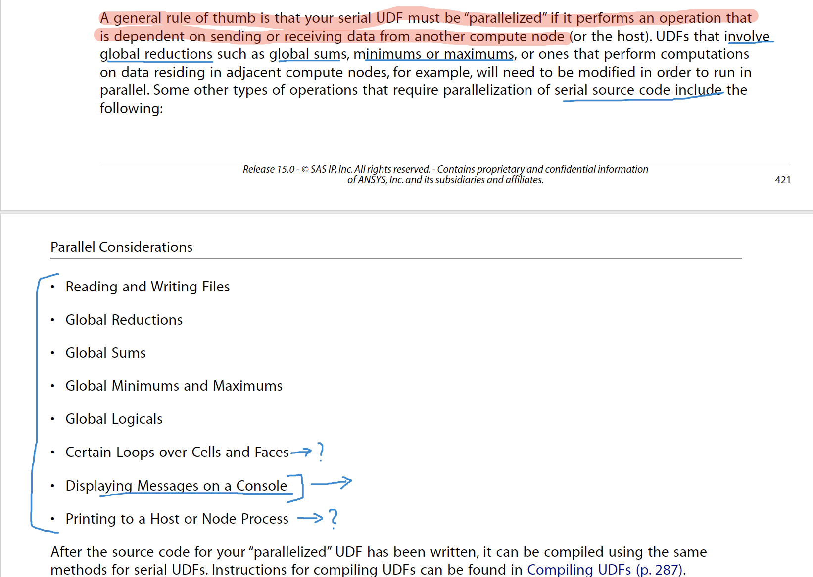

      It's not so much the main DEFINE sections that determine whether you need to parallelise the UDF but the loops and calls from within the code  https://ansyshelp.ansys.com/account/Secured?returnurl=/Views/Secured/corp/v221/en/flu_udf/flu_udf_sec_using_udfs_parallel.html    It's generally a good idea to test UDFs on a simple system, and you can try running 1, 2 and 4 cores to see whether anything behaves differently when writing your code.

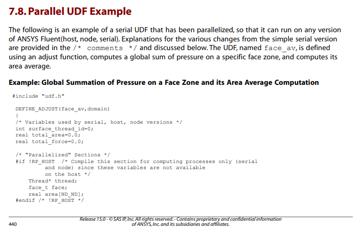

      As far as examples go how can i look for a specific command RP_HOST in a specific model example?
      I see this on documentation but i cant find its corresponding case file to understand what is going on here
      where can i find a case file for this
      Example: Global Summation of Pressure on a Face Zone and its Area Average Computation?
      There isn't a case file, the UDF examples are for you to add to your own models. Similarly, RP_HOST & RP_NODE are used in Fluent UDFs, so may be specific to Fluent.

      Bottom of the page here,  https://ansyshelp.ansys.com/account/Secured?returnurl=/Views/Secured/corp/v222/en/flu_udf/flu_udf_sec_using_udfs_parallel.html    The purpose of the example is to show how and where you need to call HOST and NODE values.
      If you just want the average pressure in your model use a Surface Integral: UDFs are not always simple and are generally specific to the required task.

      When i read the documentation this is what i see. We will have to parallelize the UDF when i encounter these situations

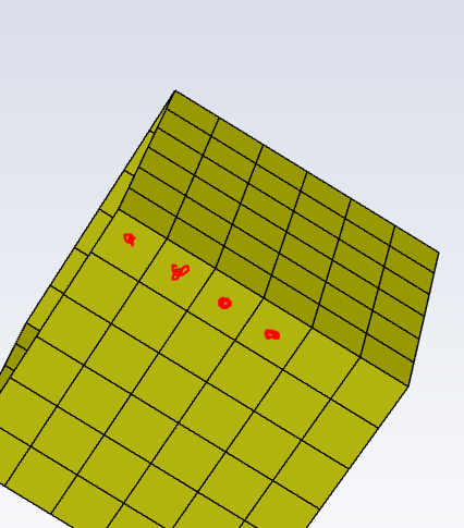

      Now i have a UDF called scalar-update that deposits some number of particles in a cell zone. This is what i get when i do volume integral sum for serial case
      This is what i get for the parallel case when i do volume integral of sum
      you can see that both the answers are not equal
      Now as far as my UDF goes I am looping over cell volume to deposit the mass in zone called part-filter.
      Q1) Do i need to parallelize anything in this udf? this is the condition i have
      if the particle thread(t) matches the cell zone thread(tm) increase udm-5.
      Q2) If not then do i have to write an execute on demand to loop over the nodes of different nodes and sum up the udm-5 because the volume integral displayed on the console is wrong?
      I am not sure where to begin. Please let me know.
