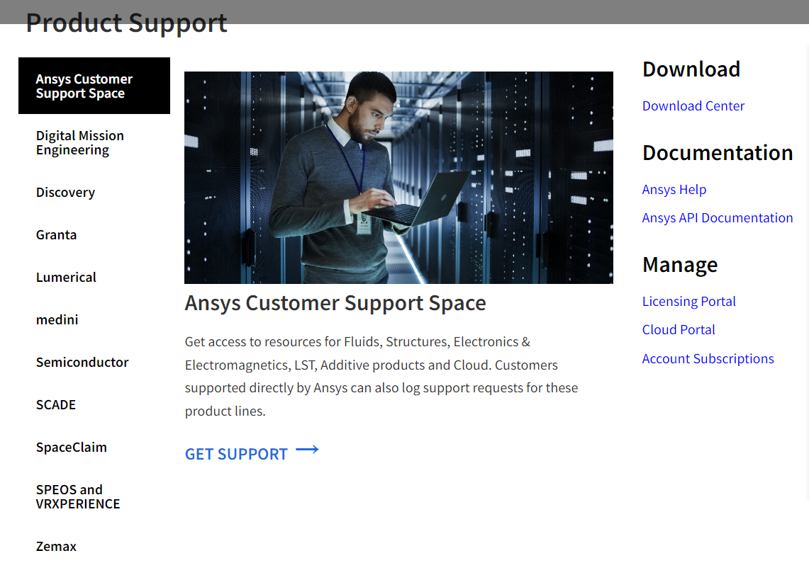

      How to use Fluent Customization Manual  ?
      When I click "GET SUPPORT"(Photo 1), I alsways stay this homepage (Photo 2).
      Photo 1:
      Photo 2:
      Click on Help in Fluent and then paste the link into the browser that opens.

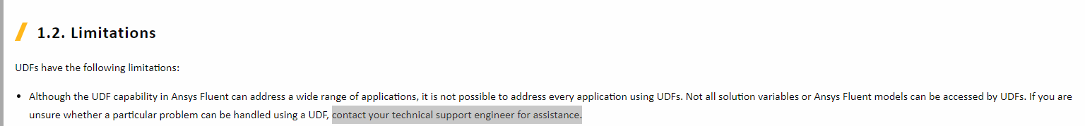

      According to Fig.,  if I am unsure whether a particular problem can be handled using a UDF, how did I contact my technical support engineer for assistance?
      Looking forward your reply.
      If you're a Student or other Academic User then we're it, and we're unable to go into much detail on a public forum. Commercial customers can (usually) contact the local office for direct support.

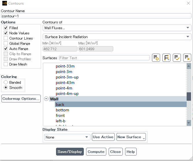

      I would like to know how to use UDF to obtain the variable (surface incident radiation) in the contour. Please see the figure.
      I tried many codes such as SV_DO_IRRAD, SV_DO_IRRAD_SHELL, SV_DO_IRRAD_OLD, SV_DO_IRRAD_TMP, etc.
      But they are not correct.
      Could you please share the correct code with me?

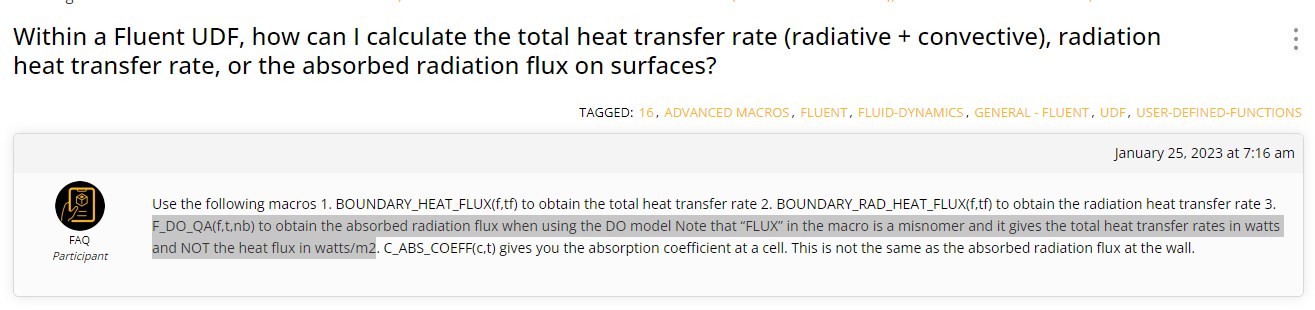

      >Not quite that simple as it's not a scalar macro. However, you may find something here  /knowledge/?s=radiation
      I learned the case provided by the URL.
      These materials give me much help.
      But I have some questions.
      F_DO_QA(f,t,nb), what is the meaning of nb.  i is the direction. I understand it.
      Could you share more materials or cases about this question? I have already searched for a long time. But no useful information.
      Looking forward to your reply.
      University or commercial user? Your supervisor/Ansys contact will know if there any arrangements in place.
      I don't know what "nb" is, but as it's the DO model it could be a grey band ID. If you have a look in the header file(s) there might be more information. As I'm Ansys staff I'm unable to offer any assistance beyond what's in the documentation or public information.
