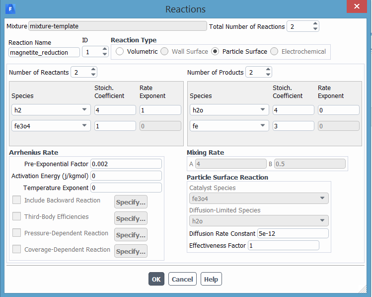

SubscriberI am trying to model a particle surface reaction, and i have activated this via the species model (see below). For this reaction, I am using the DEFINE_PR_RATE type UDF which I have hooked. Also, I have disabled the coupled heat-mass solution in the discrete phase model dialog box, as suggested in the manual. However, when doing a discrete phase iteration the UDF is not executed somehow. What is causing this?

SubscriberI have set the activation energy to 0, such that the reaction should take place immediately. Reaction mechanism has been set up using the following reaction scheme:n
The solid species here are fe3o4 and fe, and h2 and h2o are gasses. The reaction should occur at the particle surface however using the current variables for the arrhenius rate and particle surface reaction is insufficient to describe the process. Hence, I wrote the PR_RATE UDF to describe the reaction rate. This UDF should thus overwrite the reaction rate properties specified in the window above.nAlso, I am currently using a multicomponent discrete phase particle where the solid components have been re-specified. However, in reality these components are equal to the solid species. Therefore I have used the same molecular formula. I wonder though how Fluent should know that it should use these components for the particle surface reaction. Should I use a different particle type or specify my particle components in a different way?n

Ansys EmployeeYou need to use combustion particle and allow for multiple surface reaction.nAugust 31, 2020 at 6:15 pmJeroen
SubscriberI have now used the combustion particle and allowed for the multiple surface reaction and specified the species mass fractions. However, the user-defined function is still not being executed.nSeptember 1, 2020 at 10:10 amDrAmine
