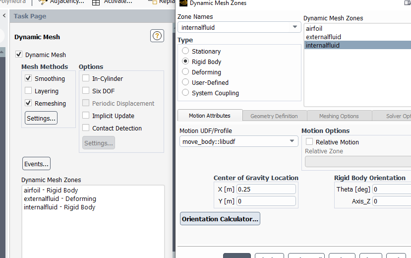

how are you assigning this motion in Fluent? Can you share a screenshot of the Dynamic Mesh zones settings?

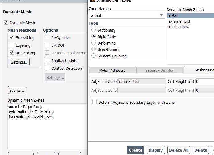

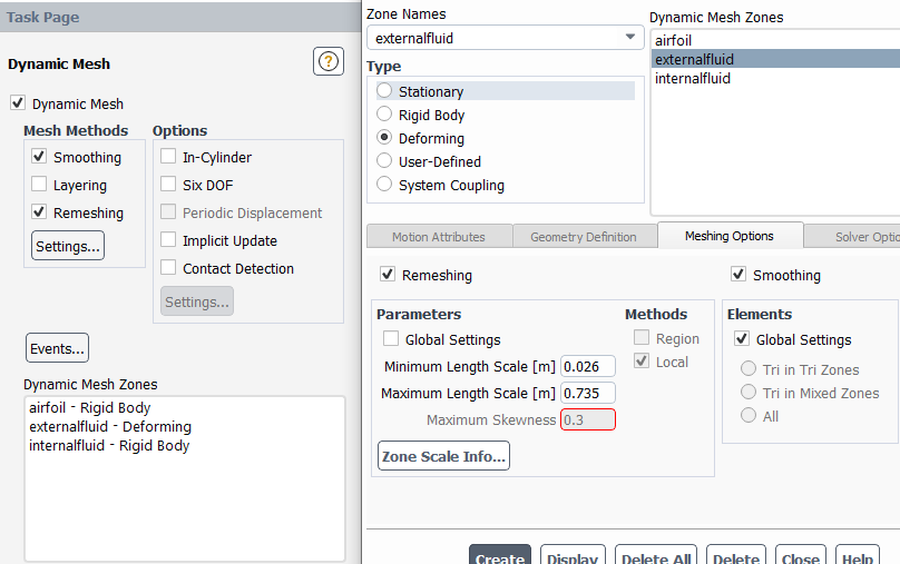

Ansys EmployeeCan you tell me what internalfluid and externalfluid zones are? Can you show a screenshot of the domain?
Also, what are the Motion Attributes for the airfoil?
