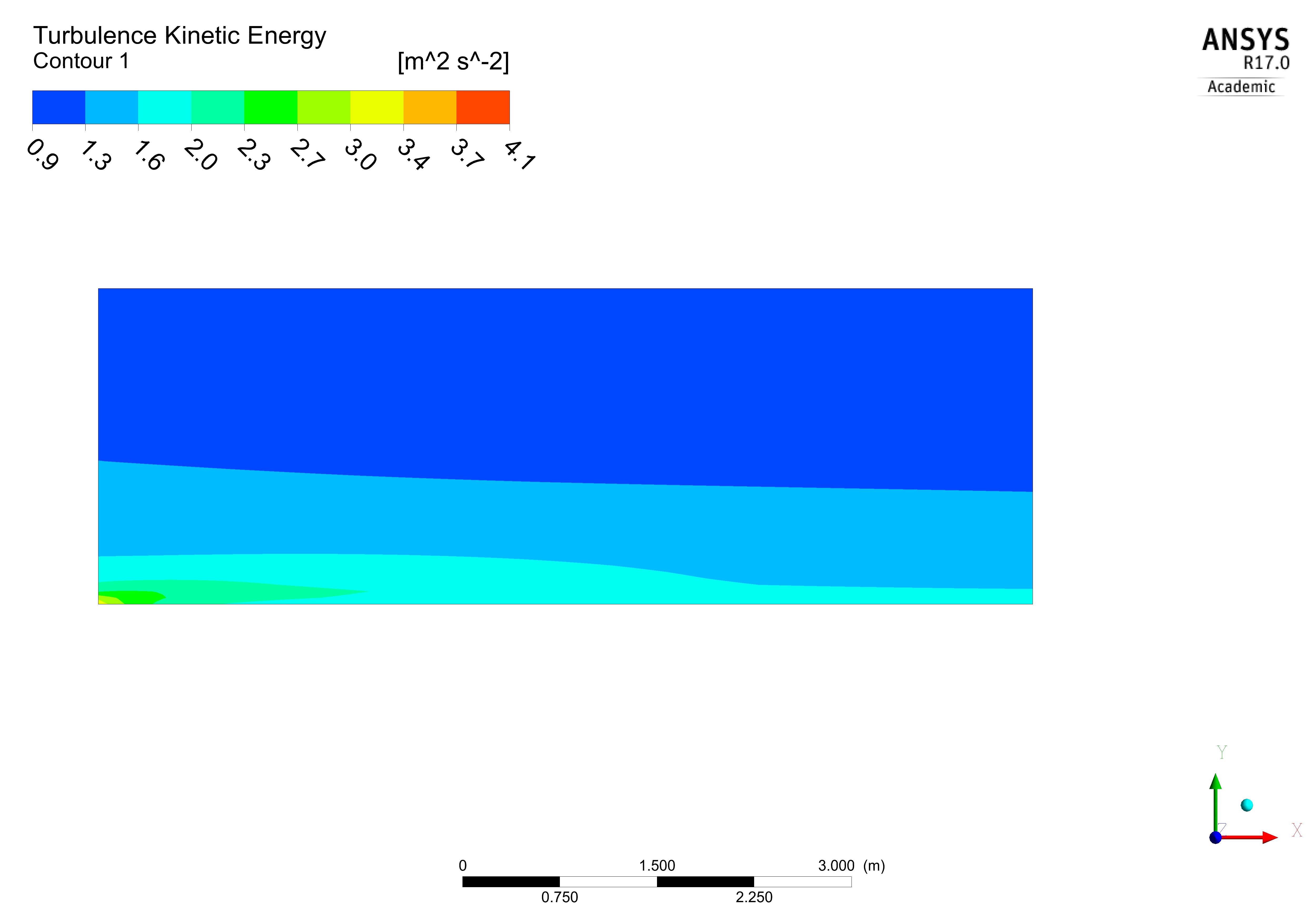

      I have been trying to simulate a homogenous ABL profile based on Richards and Hoxey's 1993 approach using FLUENT software, which requires a UDF at the inlet. I succeeded in  creating the velocity profile using the log law
      Uref= u (log(href/z0)/log(h/z0)) [shown below in code]
      Uref: reference velocity at refernce height (href), u: velocity at h (height), and z0: aerodynamic roughness height.
      The result was successful as shown:
      However, a homogenous turbulence kinetic energy (TKE) and dissipation rate (TDR) were not generated despite the inserted constant values (calculated from the mentioned apprach relative to friction velocity, u*) in the inlet display window as shown (the values were changed from 1 and 1 to differnt numbers of course).  The results changed due to the ground roughness (may be) that might be another possible influence (UDF?).
      So I tried making a UDF code for both TKE and TDR as well to keep them constant based on the codes below, but it didn't work as well, the TKE gave high values at the top and minimum (zero) at the bottom:

    • Konstantin
      could you clarify where you see the deviation from prescribed boundary profile distributions? Is it right at the boundary or inside the domain?
    • ahmadzaki
      Hi, kkourbat,
      I have problems with the k and e. they constantly start at the inlet but eventually the change along the domain (inside the domain).. the following figures show the TKE contours (left) where it starts constant(red region) then starts to reduce along the domain (gradient blue regions).
      I took three vertical line samples at the centre of the domain one at the inlet (white), middle (green), and outlet (red), then I plotted the TKE values at each line. You can see that the white line (inlet) is constant but as we go inside the domain, middle and output, the TKE reduces.
      My objective is to keep both TKE and dissipation rates constant.
      Thank you
    • Konstantin
      I don't understand why you think this is wrong. Fluent solves transport equations for TKE and dissipation rate, and they naturally evolve as the boundary layer develops downstream. They cannot be constant, as otherwise they wouldn't satisfy their governing equations and boundary conditions. You can turn off equations for TKE and dissipation so they are not solved to force constant TKE and dissipation throughout the domain. I'll let you decide how physical this would be for your particular need, as you would effectively be providing constant eddy viscosity which is never a constant in a turbulent boundary layer.
    • ahmadzaki
      I understand, however, in wind engineering we try to simulate a constant atmospheric boundary layer to match the actual boundary layer above cities and buildings. We do that, so when a building is placed in the domain we could be able to see its effect regardless of the domain effect since we are simulating large domains at which velocity, TKE, and TDR deteriorate which deviates from reality and wind environments around full-scale buildings. This is unlike domains made for aerofoils, flat plates, and ducts.
      Thanks anyway
