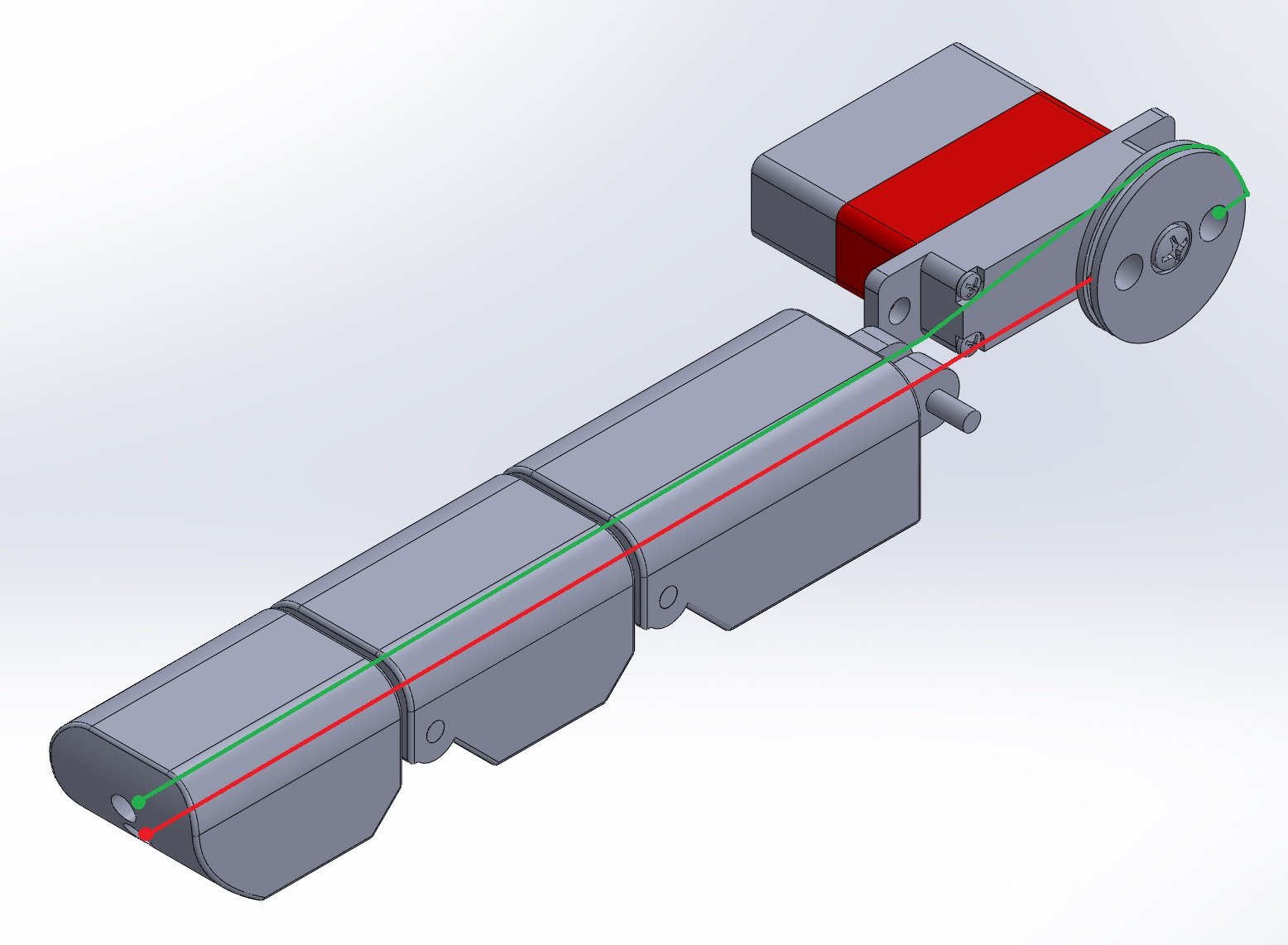

SubscriberHello to everyone, I'm using workbench 18.2, static structural, to obtain the v-m stresses and the total deformation of an index finger that belong to a hand orthosis model.Â
As boundary conditions, there is gravity, a force (22N) that represent the flexor tendon (nylon line) and a fixed support located in the pin that joins the finger with the rest of the hand orthosis.
My model have 3 phalanges that are joined together across 3 pins (these phalanges should rotate when a nylon line pulls from the finger tip alog the finger). I don't know if default ANSYS bonded contact is the right setting for the analysis or maybe another one like frictionless (between phalanges and pins), frictional, etc.?. Maybe I have to add some joints into model?
Thank you for your help and support.

Bonded contact is not useful when you have large relative motion between two solid bodies. It's for when you want to "glue" two bodies together. One way you would use Bonded contact is to glue a pin to one part, while the adjacent part that has a hole that the pin also goes through has frictional contact.
Frictional contact is useful when you want large relative motion between two solid bodies. However, frictional contact requires very careful use to get a solution.
For a pin connecting two parts to make a hinge, there is another way to connect the two parts that does not use contact. It is called a Joint and models that use joints instead of frictional contact are much easier to solve. The type of joint that makes a hinge is called a Revolute joint. To use it, you don't actually need the pin. You use the cylindrical faces of the holes on one part and call that the Mobile side of the joint then use the cylindrical faces of the holes on the other part that the pin went through and call that the Reference side of the joint. I recommend you build your first model with joints.
The nylon cord has tension, but what in the model is the tension pulling against? There has to be some spring or some part that gets compressed and provides a resistance to the tension in the cord, and that compressive force would straighten the finder when the tension in the cord is relaxed. What is providing the restoring force?
Here is a video tutorial on Joints.
https://www.youtube.com/watch?v=kkYLar2etDg

First of all, thank you for your time to gave me an answer and also I'm sorry for mi late reply but I was reading a lot about configurations and expend a lot of time doing simulations today. I read everything you said and also made some modifications to my analysis but still continue giving me some problems. I've tryed your recommendation in the following order:
1. I changed some bonded contacts to frictional (0,2,augmented lagrange and adjust to touch) and I leave only 2 of them as bonded (the middle and right phalanges with their respective pins)... after 4 attemps of 1h every simulation, doesn't work.
2. I deleted all bonded contacts with the exception of 2 of them (lateral contacts between left and middle phalanges and lateral contacts for the middle and right phalanges). Then I created revolute joins body to body (between phalanges and the pins)... after many attemps moving configurations with a total of 3h, doesn't work.
3. All contacts deleted, I worked only with revolute joins without the pins using the cylindrical faces as you said... after many attemps with a total of 3 hh, doesn't work.
I don't know if maybe the problem is due to the force of 22N that represent the flexor tendon, maybe is not properly restricted or bounded. You asked me about the tension pulling against the nylon cord, to anwer that, let me tell you that the project involve the use of mini servomotors, so when the servo pulley rotate counterwise he is pulling from the tip finger from the down side, producing the flexion effect, at the opposite side, when the servo pulley rotate clockwise he is pulling the tip finger from the up side, producing the extension effect. Below you will find some images that I prepared to show you, for better understanding of the situation.
Finally, some of the errors that many simulations gave me was: 1. an internal solution magnitude was exceed 2. one or more MPC contact regions or remote boundary conditions may have conflicts 3. The unconverged solution is output for analysis debug purpose 4. The solver engine was unable to converge, etc.
I know the v-m stresses and the total deformation of the pins and phalanges are wrong using all bonded contacts, but this situation was the only one in which there was convergence.
Maybe I have to include both nylon lines from the finger tip across the entire finger? Will be possible for you to check my analysis? Attached you will find all the project. I uploaded to wetransfer: https://we.tl/t-qfWi7L3KIwÂ
Please I kindly request your support again.

SubscriberFrancisco,
You don't want a solid body filled with solid elements to represent the cables. That is computationally too expensive. I am going to replace the cable solid body with a line body meshed with beam elements. These are computationally very efficient. The cables have to slide on the conical face of the hole. I am going to replace the conical holes with a blend radius. I'm going to put a force on one cable and a displacement on the other cable to cause the finger to curl a little.
What results do you want from this model, just stress in the parts? What about how that stress changes as the finger curls up.
Peter -

I'm agree with your modification for the cables if is more efficient is better. The cables (nylon) have a 1mm diameter and the holes for the wires through the finger have 1.2mm diameter, this way the cables can move inside the holes when the somebody are doing flexion or extension of the finger through the movement of the servo pulley. The holes are cylindrical with a fillet of radius 0.5mm, there is no problem with changes.
The purpose of the simulation is to know the stresses in the three phalanges of the finger made of ABS and in the pins made from SS304 (I started with SS304, probably I will change this pins also the ABS but depend if all the material or geometry of the finger can resist the forces). Deformations due to that 22N force finger flexion (or extension) also are of interest.
The stress changes in the finger due to finger curls down (or up) are also important to know, but I thought that this type of calculation was part of a dynamic analysis or not? I'm sorry if I'm wrong about this thought, any comments and information for my knowledge is well received

This is a very challenging problem to get ANSYS to converge on the solution. The approach to very challenging problems is to simplify them as much as possible until you get a model to converge, then you can add more detail later. This is what I did to your model.
- Made the cables beam elements
- Replaced all the pins with revolute joints
- Simplified the geometry (removed small blends) to reduce the node count for speed and to fit in the Student license
- Made the first link rigid to reduce node count and fixed it to reduce the degrees of freedom in the mechanism
- Made all the material structural steel
- Changed the contact to have lower Normal Stiffness
- Started with 400 substeps.
- Added translational joints between the cable and the first link to apply the 22 N Force and a Displacement of zero in step 1, and a 1 mm displacement in step 2 to curl the finger.
- In Solution Controls, turned on Stabilization. You can try to run it without, maybe it was not needed.

As is often the case in nonlinear models, they are a lot more stable converging under displacement BCs than force BCs.
I changed from applying 22 N to applying a displacement that results in a 22 N reaction force. Now it is being attached.
Since the nylon is only 1 mm thick, it must be stretched 7 mm to get to 21.6 N of tension. You can stretch it a bit more to get to 22 N.
