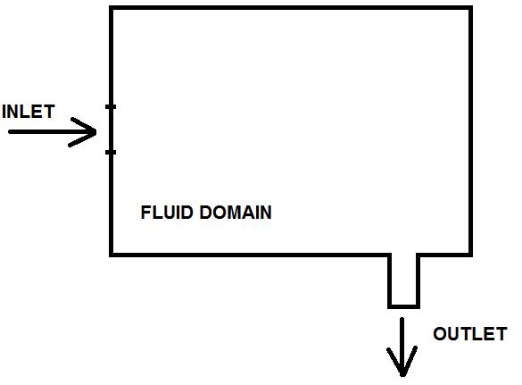

      I have two phase flow (water vapor and liquid water) in a rectangular domain with inlet of the left and outlet at the bottom. The domain is two dimensional (2D). The domain has gravity acting in the -ve Y direction. I used the Eulerian model for the two phases. I have velocity inlet and pressure outlet BC.

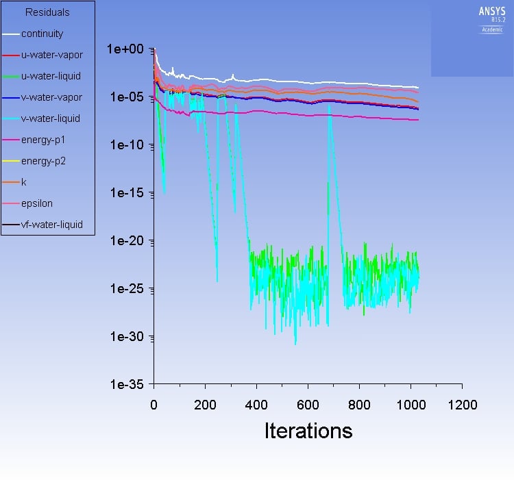

      1. Pseudo-transient analysis with only water-vapor entering the domain. It converges and the results are perfect. The residual plots are as shown below
      2. Pseudo-transient analysis with water-liquid volume fraction of 0.1 at the domain inlet. I cannot get convergence. The solver diverges stating that "turbulent viscosity ratio" is higher than 1e5.
      I looked into the turbulent viscosity ratio warning. My maximum skewness is 0.02, so the mesh is okay. I tried the recommendation to turn off turbulence for 100 to 200 iterations and turning them back on...but the solution diverges.
      I even tried a laminar case, and the solution diverges! I tried transient case, but the solution diverges!

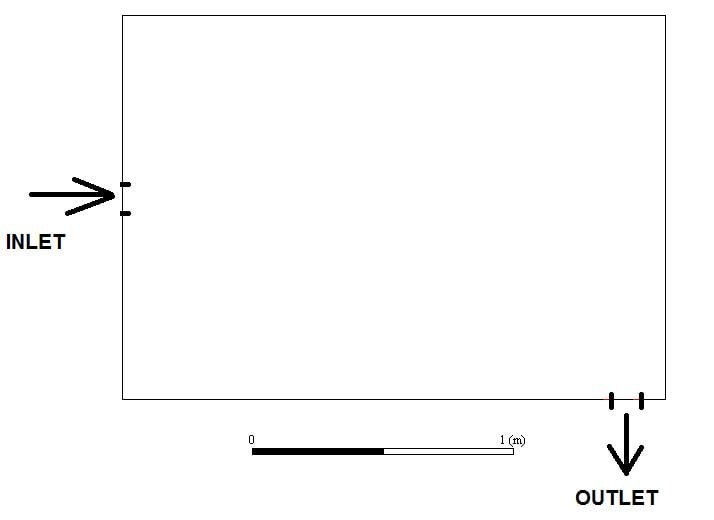

      Thank you for the suggestions! I will decrease the iteration per time step. Also, for the outlet this is the venturi pipe you suggest? I did not understand the plenum option, the outlet in the original domain is already horizontal!
      Best regards,
      Hamed.
    • Amine Ben Hadj Ali
      Ventu pipe as convergent nozzle. My idea is to avoid any kind of nonphysical reversal flow.

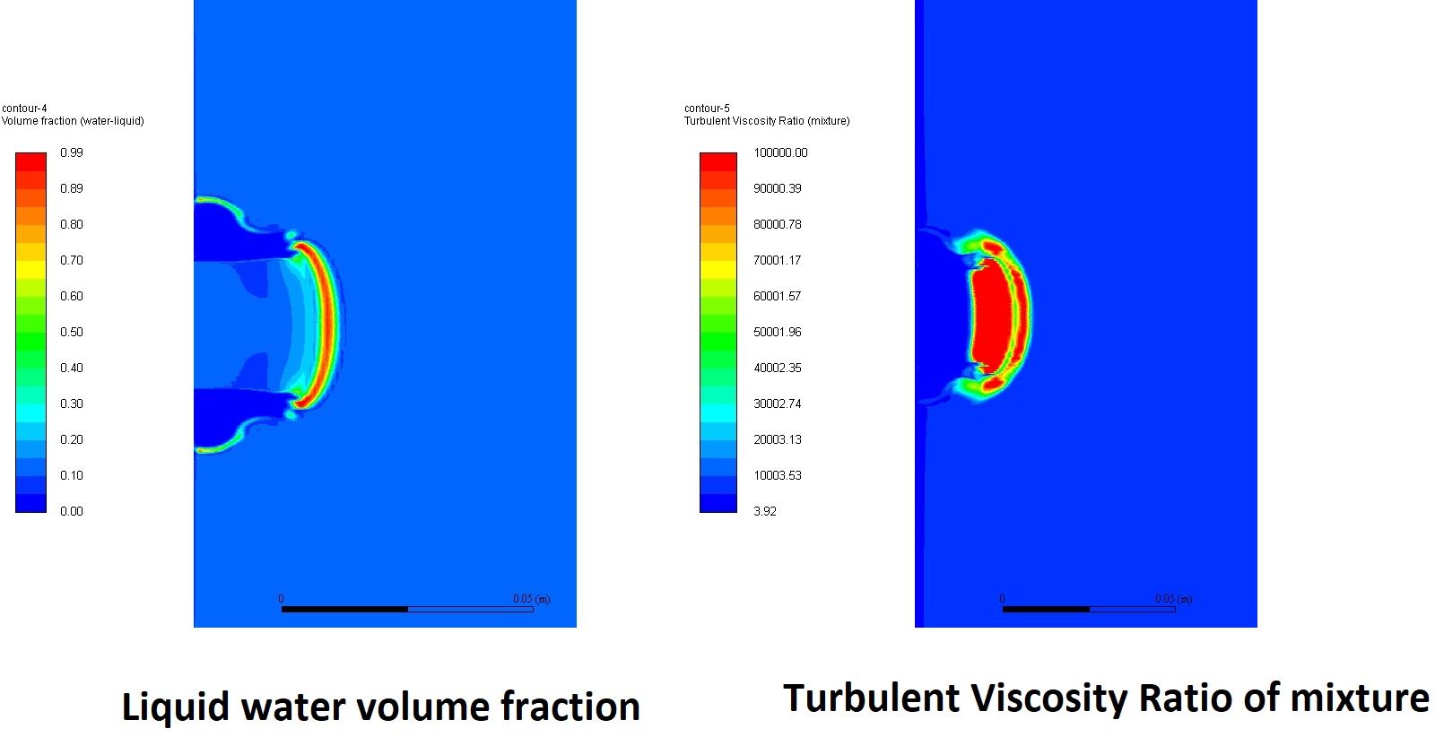

      I have a turbulent case up and running with the old geometry! It's not showing any flow reversal now. I have the following questions:
      1. The turbulent viscosity ratio > 1e5 is still there! I have defined a turbulent intensity of 1 % (previously it was 3.7 %). Below is the zoom-in image of the turbulent viscosity ratio and water liquid volume fraction. My understanding is that the turbulent viscosity ratio is higher where the water vapor condenses to water liquid!
      Should I ignore the warning of high turbulent viscosity ratio?
      2. Currently, I have set the global courant number to 0.75 and using variable time-step (e.g. now the time step is 1e-6 seconds). The simulation is running super slow. Please can you suggest how can I accelerate it? I tried Courant number of 2, but the solution diverges!
