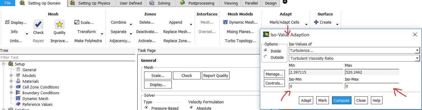

seeta gunti
Ansys EmployeeHi Raju,
You can display the turbulent viscosity ratio contours and check the region where it is limiting. You can adapt the mesh accordingly in FLuent and check if the turbulent limiting cells are coming down or not.
I attach the pictures for your reference. In the attached picture, turbulent viscosity ratio is ranging b/n 2-520. So I did not give any values for iso-min and iso-max. In your case, you can give minimum as 100k and max is your maximum value and mark the cells. Display the cells and adapt the region accordingly and run the simulation.
Hope this might help you.
Thanks,
Seeta
