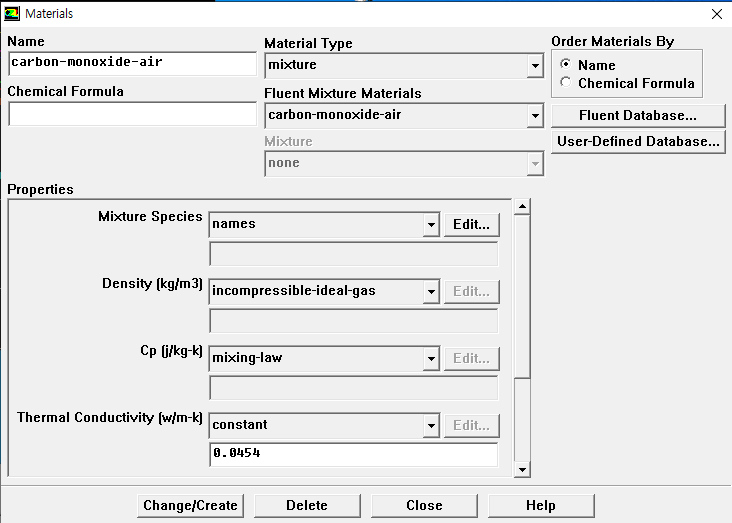

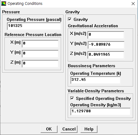

I set both of the portals as pressure outlet with the temperature of 310K and put energy value to the fire. I used SIMPLE and Body weight force scheme. I initialized with the tempeature of 310K and put the air density of the domain(around 1.1kg/m^3) on the Specified Operating Density under Variable-Density parameter (I definitely included gravity)
Does it seem to be a probable model setting?
Moreover, if you could possibly give some information on what would be different between putting specified operating density and leave the setting as default (unchecked). Could you recommend some materials that I can refer to, apart from the user's guide?

Forum ModeratorLooks about right, you're probably OK with incompressible ideal gas, if the flow is fast enough to be fully compressible the fire may be the least of your worries! Did you use ALL of the decimal places in the operating density?Â
https://ansyshelp.ansys.com/account/Secured?returnurl=/Views/Secured/corp/v231/en/flu_ug/flu_ug_bcs_sec_operating.html Focus on the text just above eqn 7-68. Â

SubscriberYes, I am using incompressible-ideal-gas, and I put the initial density on the specified operating density.
I've looked up some materials and they say if I use the incompressible ideal gas option, I should put 0 in the specified operating density. Wondering if that is correct and if it makes sense?
Lastly- Could you tell me what I will have if I adopt incompressible-ideal-gas and not specify the operating density? Would the bouyancy caused by the fire be generated? I am still very confused about this operating density option.. and about what it does.

SubscriberRob, thanks to your help I finally finished the project. I still have some uncertainty about the setting operating density:Â
1. For single phase imcompressible ideal gas, If I set the operating density to 1.00kg/m3 for example, the bouyancy induced by the density difference will be triggered if the density is changed from specified density?Â
2. If I don't specify the operating density, what is the difference from the specifying the operating density?Â
3. What's better option when the large density change is expected? Should I specify the operating density to the ambient air denstiy or should I leave operating density unspecitied.Â
June 16, 2023 at 11:15 am
Rob
Forum ModeratorÂ
The density value is set to assist at the domain outer flow boundaries. If rho_operating – rho_outside is zero you can set the pressure boundary as 0 Pa. If you don’t get a zero difference you need to account for boundary height against the difference so pressure becomes a profile and varies with height.Â
For a couple of metres the pressure variation on the boundary isn’t much, but in natural convection flows the driving pressure for the flow is also very small.Â
Hopefully  /courses/index.php/courses/heat-transfer-modeling-in-ansys-fluent/lessons/how-to-model-natural-convection-in-ansys-fluent-lesson-4/ will explain more clearly. The search tool was upgraded overnight, so we can look everywhere rather than just in the Forum.Â
