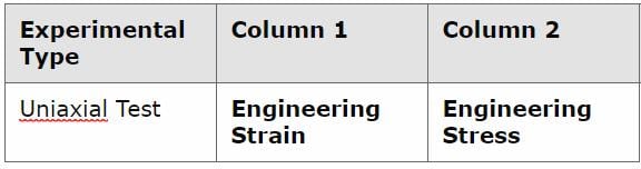

      this is a post about the topic previously discussed, but I'm very confused thus I need a confirmation from you. I've read different answears about the data to be used as input to create a new material from experimental data. Ansys Help reports the use of engineering stress/engineering strain, but about isotropic hardening I've read to input true stress/plastic strain. Why? However, can you confirm to use eng. stress/eng.strain?
      Please clarify these aspect. Thanks!
      Here are a few excerpts from the ANSYS Help system.
      6.3.2. Step 1. Prepare Chaboche Experimental Data
      Curve fitting requires experimental test data. To use curve-fitting with plasticity, the only experimental data supported is uniaxial test data. Uniaxial test data has two columns, plastic strain and true stress.
      6.1.2. Step 1. Prepare Hyperelastic Experimental Data
      Table 6.1: Experimental Details for Case 1 and 2 Models and Blatz-Ko
      So you see that depending on which material model you are building with experimental data, one requires true stress while another requires engineering stress.

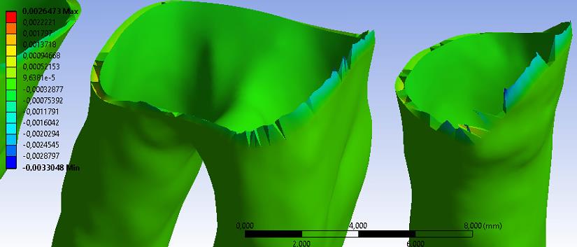

      Hi Peter, talking about deformation..looking at the direction deformation (along Y) result of my simulatio, I noticed that there is a displacement along -Y axis (bodies are in the YZ plane Z is vertical, Y is sagittal, but they move anteriorly along -Y and inferiorly along -Z as it should be), but half of the scale values about deformation are positive and half are negative. Why aren't they all neagtive since the movement occurs in the opposite direction of Y axis? Have a look at the picture; I set a 0.5X scale to better appreciate the deformation. Actually it is so small that is not perceivable. (Basically looking at this picture the movement should be from left to right and downwards).
      directional deformation along Y axis
      Thanks
