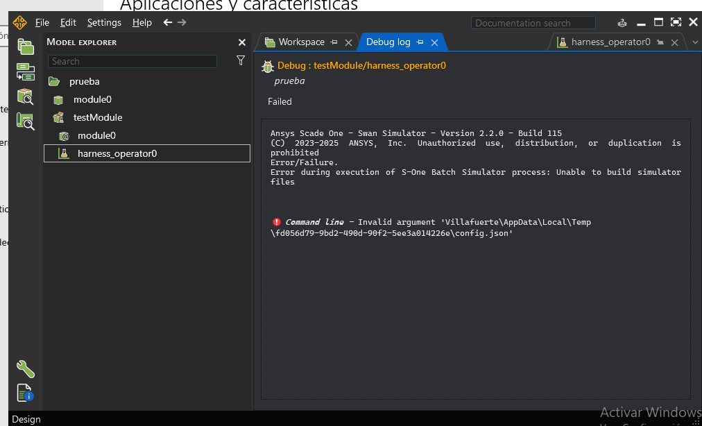

SubscriberI've been using Ansys Scade v241 with no problem whatsoever, but recently i've downloaded Ansys scade One, im just trying to get through the tutorial, but whenever I need to Debug, it throws me the shown error.
I get that maybe a problem could be that my username is 'Benjamin Villafuerte...' and the space in between may be something to consider.
The thing is that I've already uninstalled everything related to Scade One in that direction ('C:\Users\Benjamin Villafuerte...') and tried to install it on a different path ('D:'), but the problems keeps happening.
I would really appreciate any kind of help..png)
Respectfully yours,
Benjamin -

Ansys EmployeeHello,
Do you have the same kind of error whatever the project used? Or is-it specific to this project?
I would like to determine if the problem is related to your environment or to a given project.
Thanks
