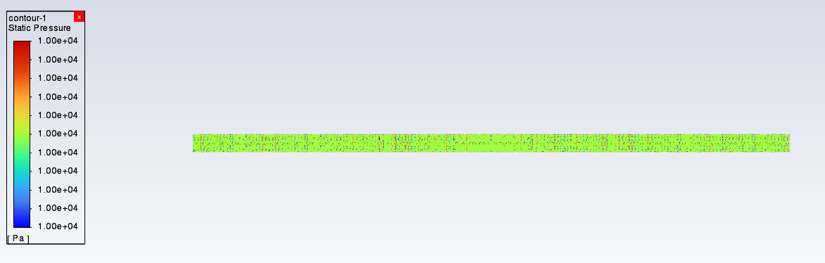

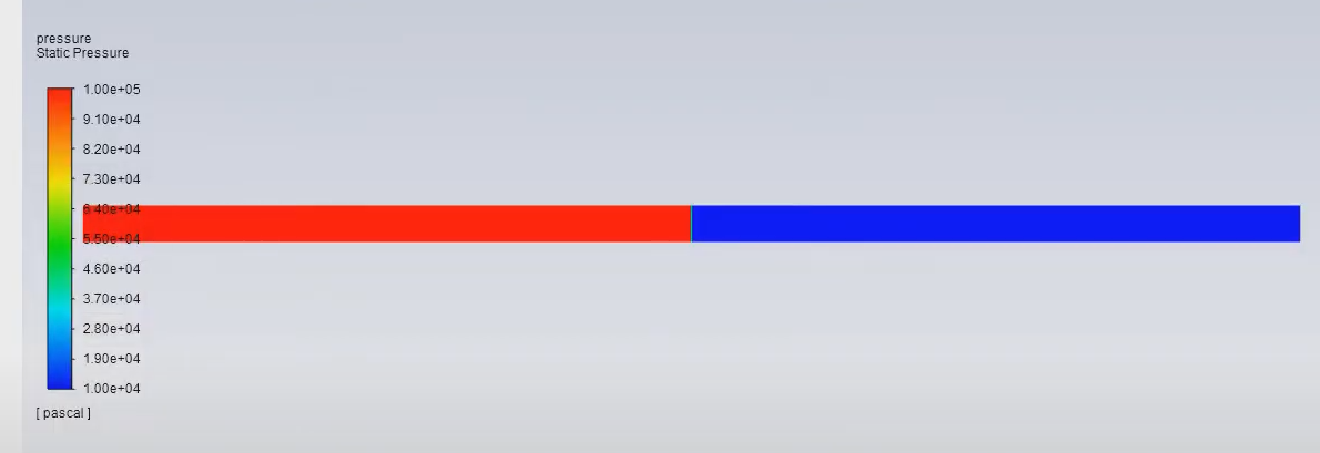

      [4:15] Once the initial parameters have been entered, the contours for the static pressure are displayed, and in the example the tube is clearly shown and red and blue like below.
      However, after numerous attempts to replicate exactly which functions were clicked and the values entered in, I am always getting this green bar with scattered coloring.
      From then on, all of the plots do not match and the example is essentially incorrect for me. I have gone through the example several times and cannot seem to find where the issue is, and what I can do to fix it. Any help would be greatly appreciated, thank you

      The second image looks like you initialised and then didn't patch, or used hybrid. Check that step.
