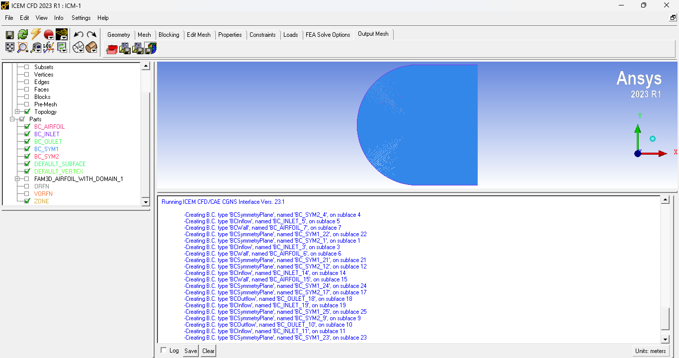

I have another troubling situation. I created a 5-block-structured grid. As this is multiblock, the boundaries are also split into blocks (subfaces). As you can see in the attached figure, for example, 'BC_AIRFOIL_7', on subface 7; 'BC_AIRFOIL_6', on subface 6; 'BC_AIRFOIL_15', on subface 15:: I want to keep all the boundaries associated with the AIRFOIL under the same name, 'BC_AIRFOIL', without any other extensions based on surface. Could you please tell me whether there is any way to give the split boundaries a single name or merge the subfaces for the boundaries?

Ansys EmployeeI think you can merge them in solver.Â
