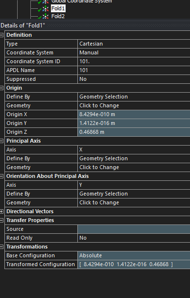

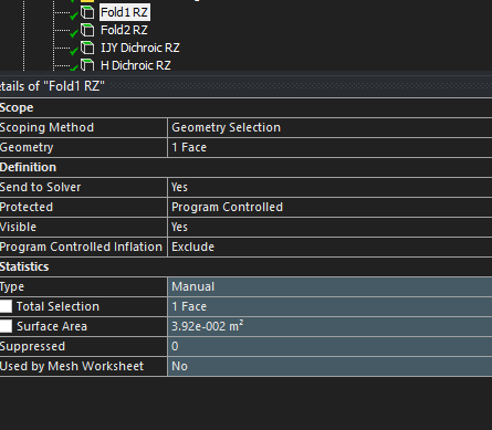

      This is the part of my code where I set the named selection and local coordinate system I would like to use:
      ! Define the single named selection
      NamedSelection = 'Fold1 RZ'
      CoordSystem = 101
      CSYS, CoordSystem  ! Set the coordinate system

      ! Apply the Named Selection (ensure the selection is active)
      NSEL, S, NAME, NamedSelection
      Here is an image of the coordinate system:
      And here is the named slection:

      Hi
      See this and the help manual (command ref. section in mapdl help):
      20 APDL Commands Every ANSYS Mechanical User Should Know – PADT
      For instance to choose named selection issue:
      CMSEL,S,Fold1RZ
      All the best
      Erik
