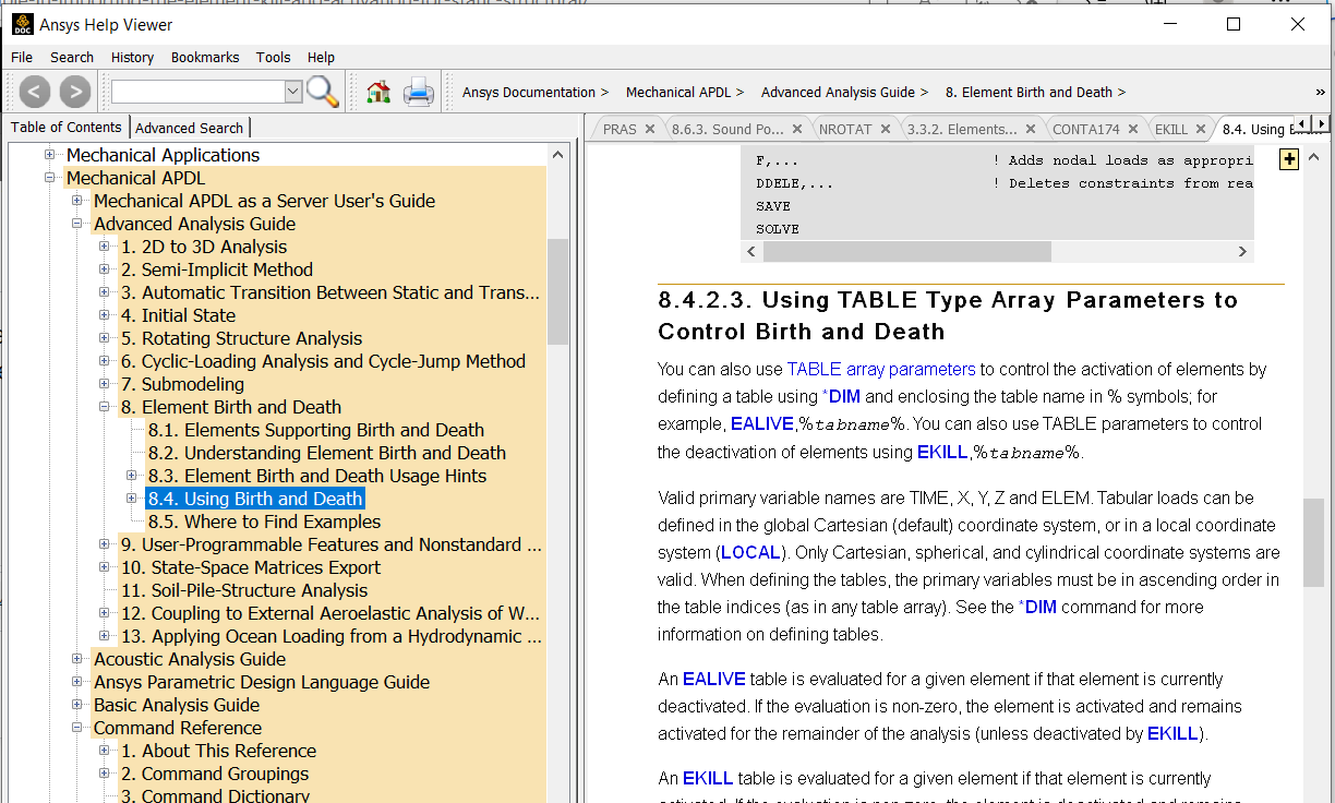

      I'm pretty sure you'll have to manually redefine the EKILL/ALIVE element activation sequence in the structural analysis. This aspect of element status (active or "live" versus inactive or "dead") is NOT saved to the thermal results file, so it is not automatively transmitted to the structural analysis.
      You might consider inspecting the thermal ds.dat file (if the thermal analysis was set up in Mechanical) to see what commands were used to implement the element activation process. It's possible that a table array was used as described below. If you you might be able to use this same table array to specify the element activation sequence in your structural analysis. PARSAV,ALL may be used in your thermal analysis to save the paramaters to a .parm file. PARRES may be used to read those parameters into your structural analysis.
