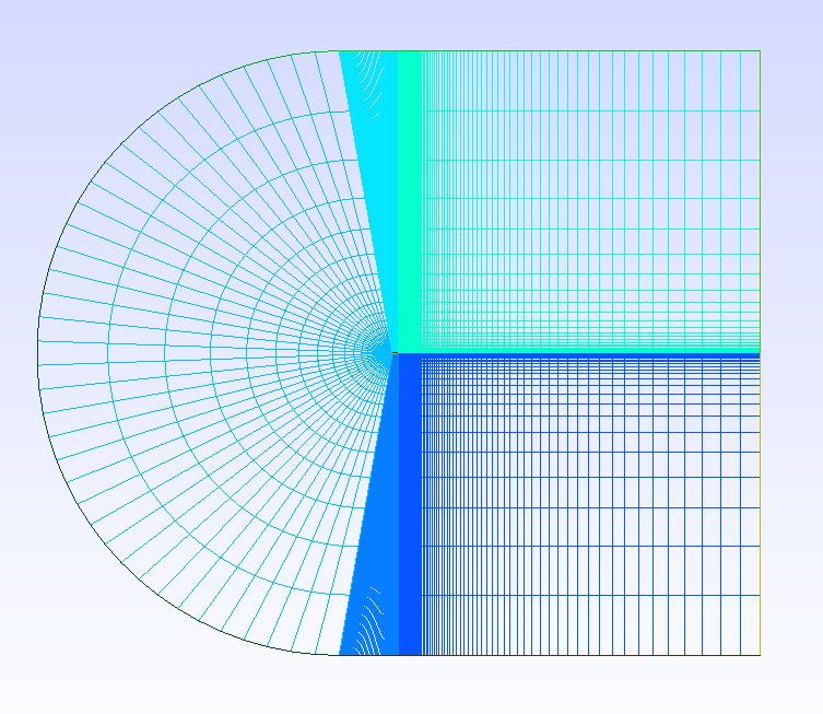

SubscriberYes I have tried. Now I tried with a simple geometry i.e a rectangle and when fed into fluent meshing it is showing:
Warning: no nodes readanalyzing boundary connectivity...done.
Meshing>
But here in GMSH the statistics is showing this:
I have also uploaded the .msh file.
Till now not reached to any satisfactory state.

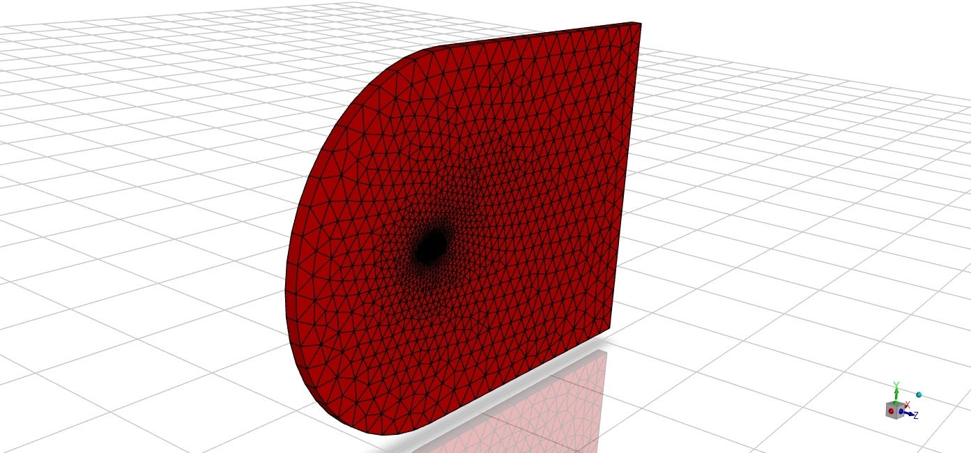

SubscriberHi Rob, thanks for your response again. Actually, I am trying to keep my mesh intact i.e what I obtained from GMSH. So, after lot of research I have found a way, firstly I exported the mesh from GMSH to Openfoam and then openFoam to Fluent as .msh file. I was finally successful in reading the same mesh file(i.e obtained from openfoam) in Fluent 2D as well as 3D. Now, what I saw the domain is having a single cell thickness and I am wondering will it be possible to run a 2D simulation in that regard? If so can you please suggest me a b.c for the front and back face(in openfoam it was kept as empty patch) whereas I am trying pressure far-field b.c for inlet and outlet. I have attached the pic how the mesh looks like.
February 9, 2022 at 10:15 amRob
Forum ModeratorOK, that sounds like the GMSH export isn't respecting the Fluent mesh requirements. Given it's one cell thick it's 2.5d and isn't quite 2d but doesn't show as 3d. I'll flag to DEV in case we need to update any readers.
Moving back to your model, in 3d. Make the z boundaries symmetry and set the perimeter faces to suit the model. Assuming it's an airfoil (from the domain shape) pressure far field is a good starting point. Walls for the bit in the middle.
February 9, 2022 at 10:27 amRob
Forum ModeratorAnd a very quick response - we think GMSH isn't exporting a true 2d mesh. CFX also uses a 1 cell thick 2d approximation so the terms may have been muddled in GMSH. Fluent's 2d approach is true 2d in that there is no z coordinate.
