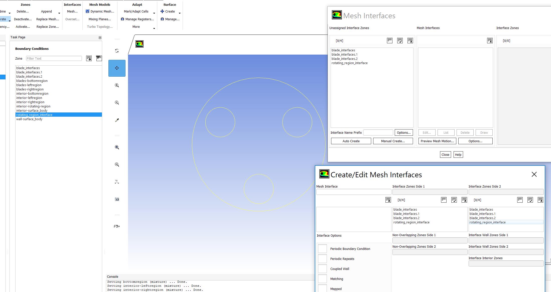

      I am doing a project modeling a darrieus type wind turbine. I have created the following mesh, and am onto setting up a moving frame of reference. The only issue, is that the option to create mesh interfaces seems to be disabled. Please help!

    • Amine Ben Hadj Ali
      You need to check in Fluent whther the contacts are set to walls. If yes change bothbto interfaces and then create the interface connection

    • loganunser
      Hi!
      I tried to do what you said, but only had Fan, interior, porous jump, radiator, and wall as options. I've attached pictures of the interface I was trying to change. Thanks for your help!

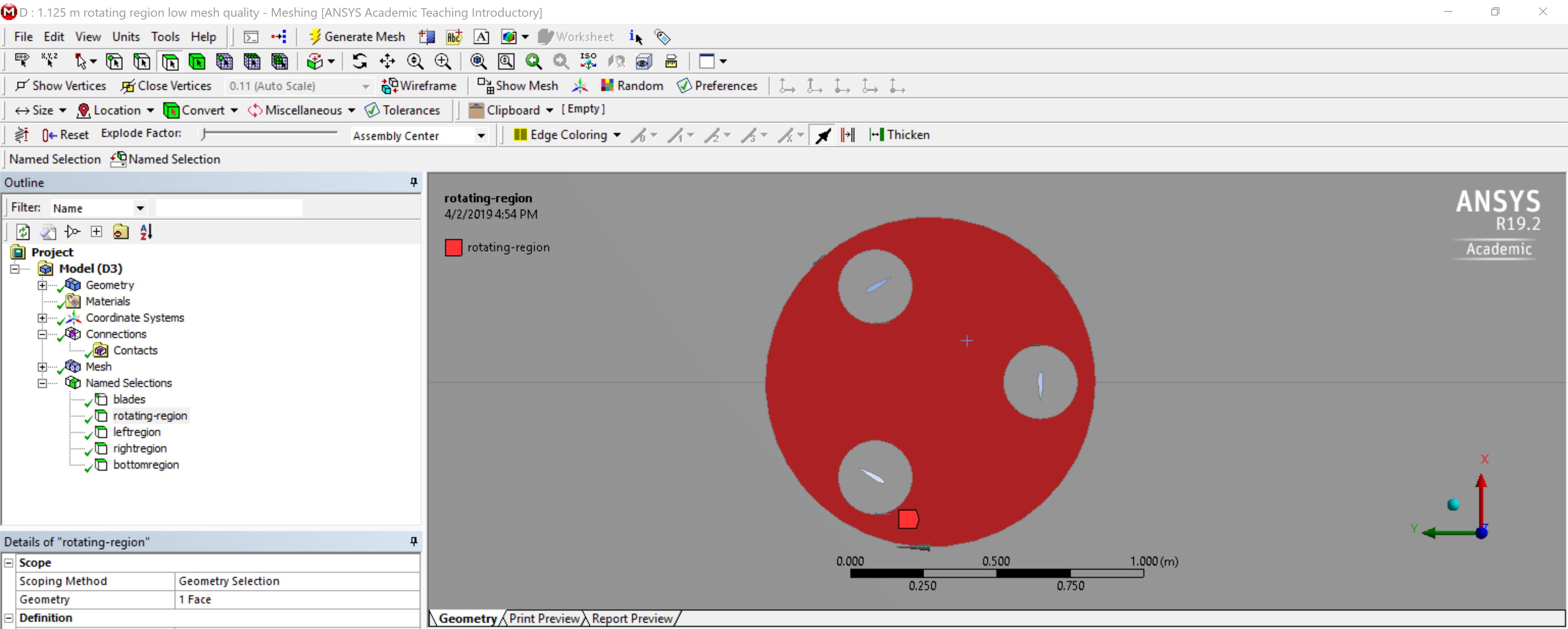

    • loganunser
      I Figured it out! I just needed to have named selections in the mesh.

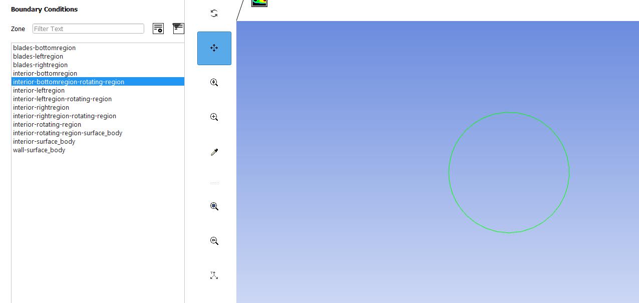

      Turns out I got a little excited. I have the circular edges as interfaces, but from what I can tell you need two lines to create the interface. Please help!
