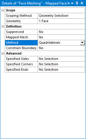

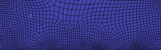

Subscriberi set to quadrilaterals only.
April 18, 2023 at 8:04 am
NickFL
SubscriberFor that rectangle you can use Face Meshing (formerly Mapped Face). If you just say Quad Dominate, I think it is using the old paver approach that will stick triangles in occasionally.
