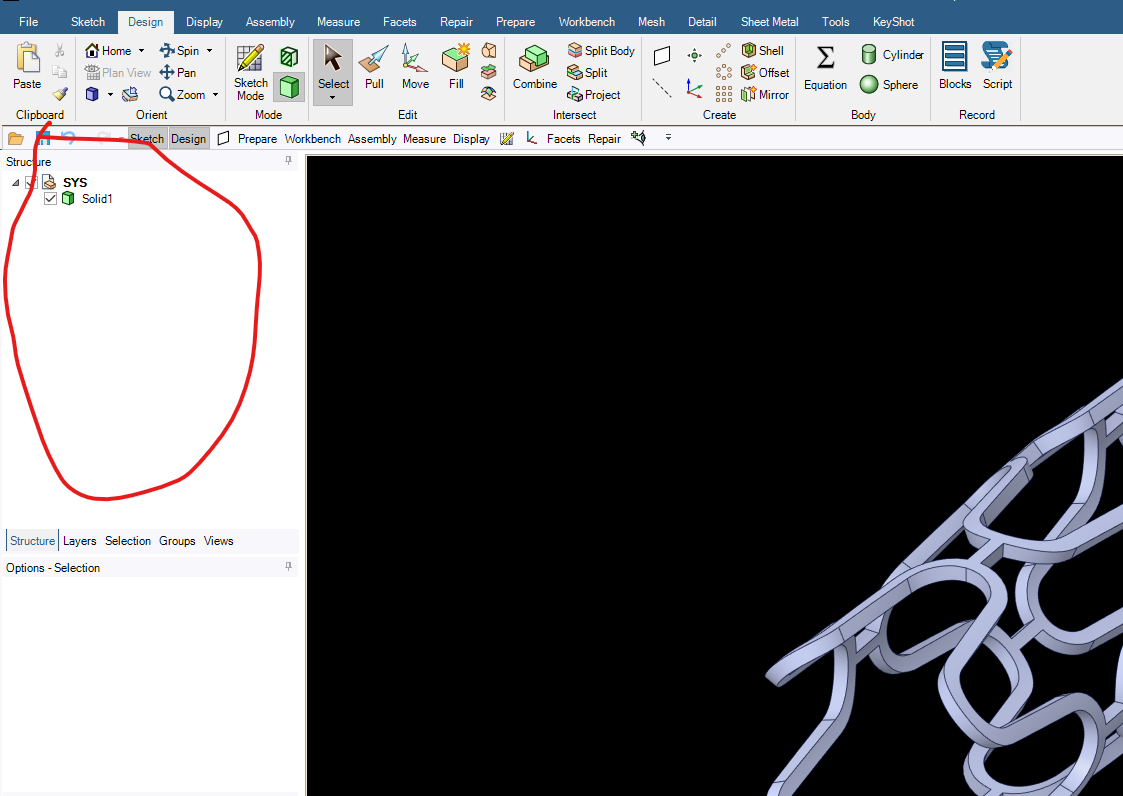

SubscriberDecember 9, 2021 at 10:44 amRuturaj Gavali
Ansys EmployeeHey !
If you are expecting for a list of operations, like the one available in Design Modeler, you won't get it in SpaceClaim as it is not a history based modeler. Other than that I don't see anything missing in the tree.
Still, you can try the following:
Try uploading and editing the geometry again in SpaceClaim.
In SpaceClaim, go to File >SpaceClaim Options >Appearance and pick "Reset Docking Layout".
Thanks!
For more information, check out the following links:
Ansys Help
Ansys Learning Forum (Rules & Guidelines)
December 9, 2021 at 12:39 pmRuturaj Gavali
Ansys EmployeeHey !
If you are expecting a list of operations, like the one available in Design Modeler, you won't get it here as SpaceClaim is not a history based modeler. If not, I don't see anything missing in the tree.
Still, you could try the following:
Try uploading and editing the geometry once again.
In SpaceClaim, go to File> SpaceClaim Options> Appearance and pick "Reset Docking Layout".
Thanks!
Ansys Help
December 9, 2021 at 5:20 pmMrroy
Subscriberrgavali thank you for your reply,how to open in Design Modeler,geometry file was always opening in space claim
December 10, 2021 at 10:36 pmpeteroznewman
SubscriberThe geometry shown in the image is from this course: /courses/index.php/courses/cardiovascular-stent/lessons/geometry-lesson-3-4/
The stent was designed in SolidWorks, which is where all the features used to create the shape would be visible if you had SolidWorks and the original file.
However, the geometry is provided for the ANSYS course as a Parasolid file, which means it is purely a boundary representation of the solid with no feature history.
The file name is simpleStent.x_t and you would first start DesignModeler, then use the File, Import External Geometry File and select this file.
I suggest you learn SpaceClaim. Why do you want to open the file in DesignModeler?
