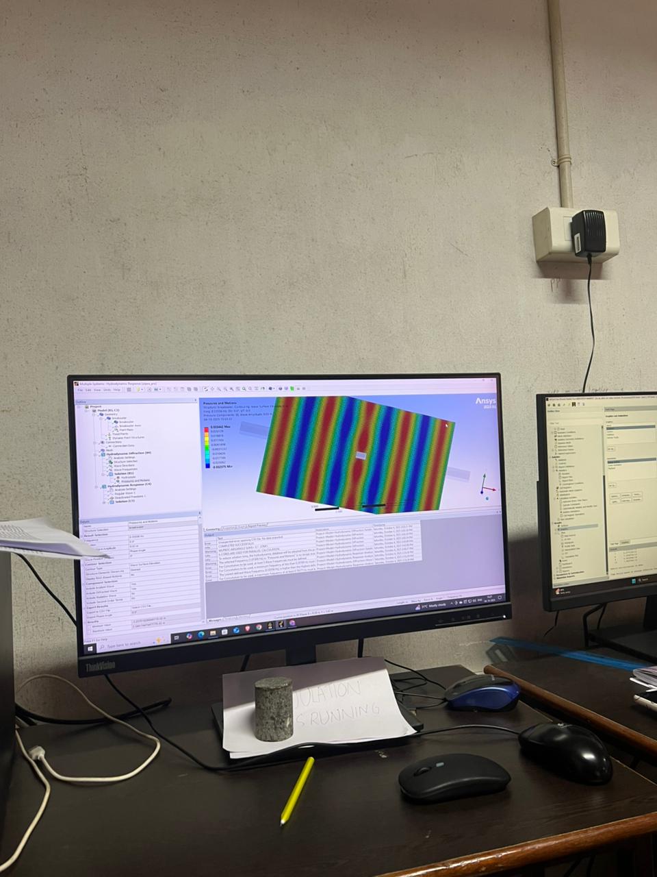

    • Sreelakshmi_m240589ce
      Why it's showing like this ,when an obstacle comes ; elevation must change right?
    • Mike Pettit
      In this case the scale of the diffracted and/or radiated wave is small compared to the incident wave amplitude. In other words, the diffracting/radiating effect of the structure is relatively small, because the structure dimensions are small compared to the wavelength of the incoming wave.
      You can use the Component Selection in the Pressures and Motions details to choose which wave components to include in the wave surface plot. For example, you could turn off the 'Include Incident Wave' option to make the wave disturbance more visible.
      Mike
