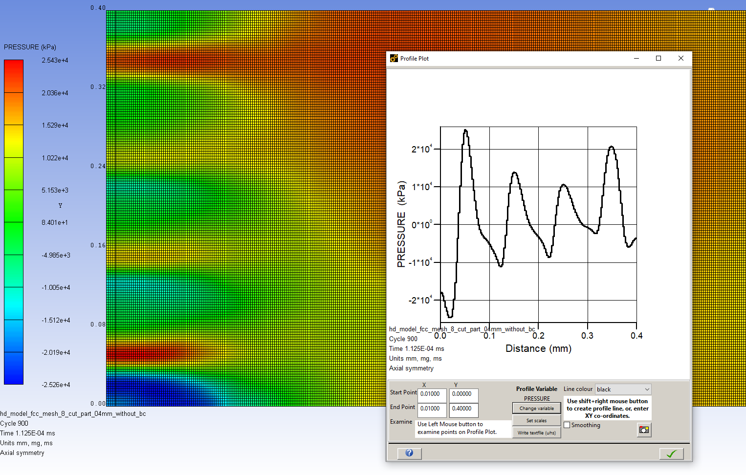

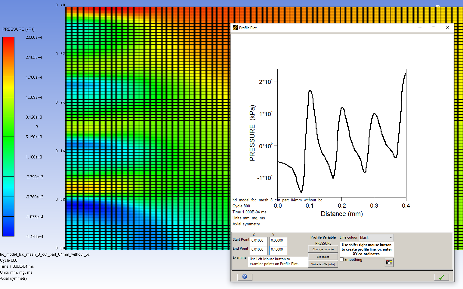

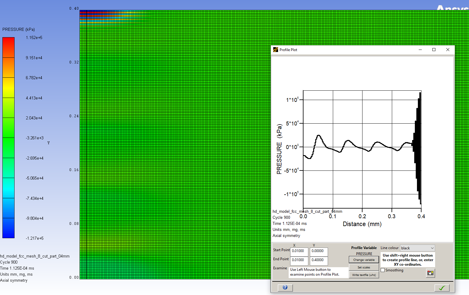

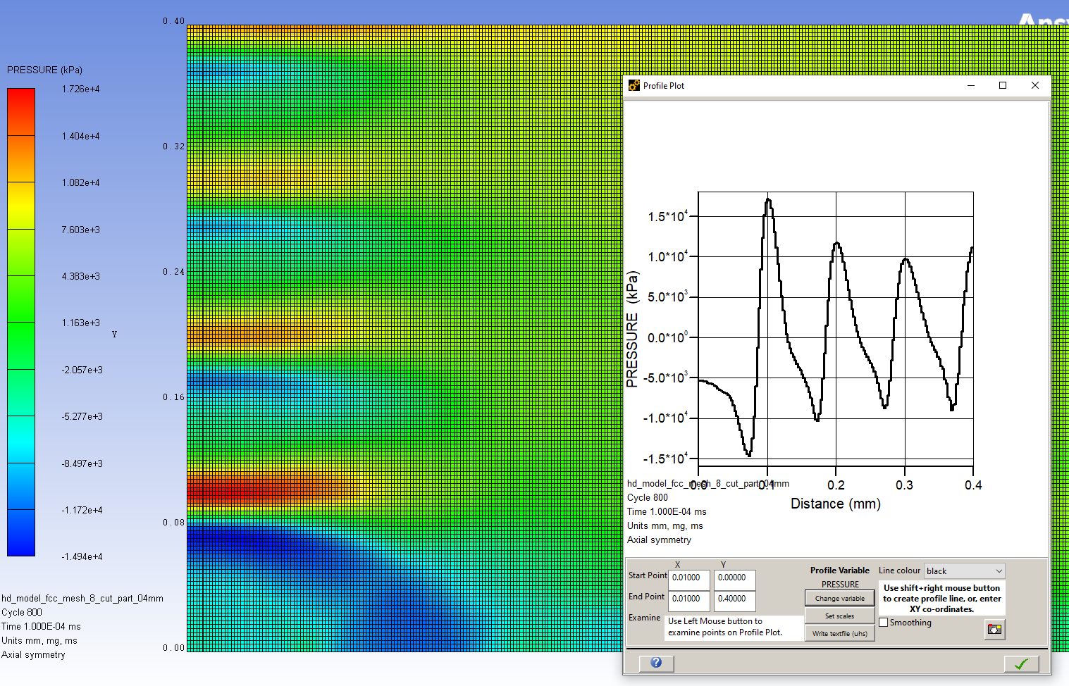

      I am using Ansys Autodyn 2023 R2 to simulate the impact of an energy beam.
      For this simulation I am using an Eulerian mesh, no failure or strength model, and I apply only one boundary condition at the upper radius (0.4mm cf. images) which is "Transmit (Euler/Lagrange)". All references in the boundary definition are set to zero.
      I do not understand why my pressure wave is disturbed by this boundary condition. Should it not allow the wave to pass through as if the material were continuous?
      Below is a comparison of the results obtained without the boundary condition (total reflection of the wave) and with the transmit condition (creation of a disturbance with a large amplitude).
      How can I solve this problem without enlarging my part?
      Thank you for your help,
      Audrey
       No_boundary_condition_cycle_800No_boundary_condition_cycle_900Transmit_boundary_condition_cycle_800Transmit_boundary_condition_cycle_900

      For multi-material Euler solver, usually Flow Out boundary condition is used. Can you try the Flow Out BC to see if you still observe the large oscillations of pressure near the boundary? Make sure the correct material is selected for flow out or set it to ALL Equal.
      For impact simulations, it is OK to observe a rarefaction wave after the initial compressive wave.
      From the profile picture included in your description, I estimated that the sound speed of the material exceeds 10000 m/s, which seems large to me. Can you carefully check the material properties in your model to make sure they are accurate?

      I tried with the "Flow Out" boundary condition + Sub option "Flow out (Euler)" + Preferred Material "the target material" but I obtained excatly the same results as in the simulation without any boundary conditions.
      Yes, I checked and the soundspeed of the material is well defined, around 4100 m/s, which is the case here 0.4 mm / 1e-4 ms = 4000 m/s.

      Actually, for compressible materials, its sound speed may not be a constant. It should be related to dp/dr, where p is pressure, r is density. You can do a contour plot of sound speed to check its magnitude.
      If the problem still persist with new Flow Out BC, you need to extend the Euler domain.

      It seems that the "Transmit" boundary condition in Ansys Autodyn is causing an issue due to the way it handles material interaction between Eulerian and Lagrangian grids. This can lead to discontinuities or disturbances in the pressure wave. You may need to refine your mesh near the boundary or consider an alternative boundary condition like "Absorbing" to mitigate wave reflection.
