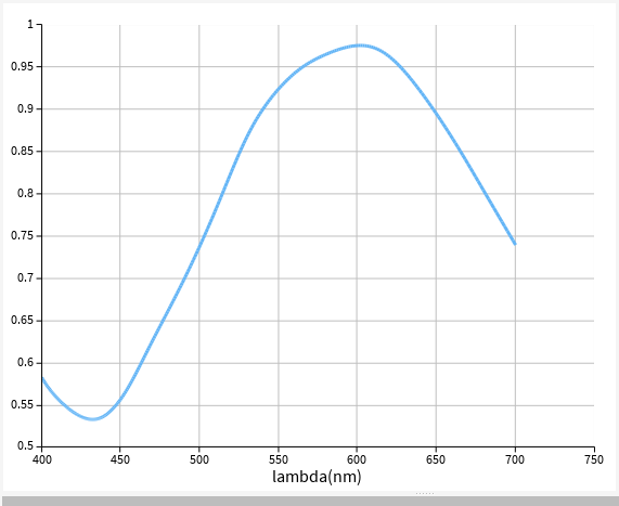

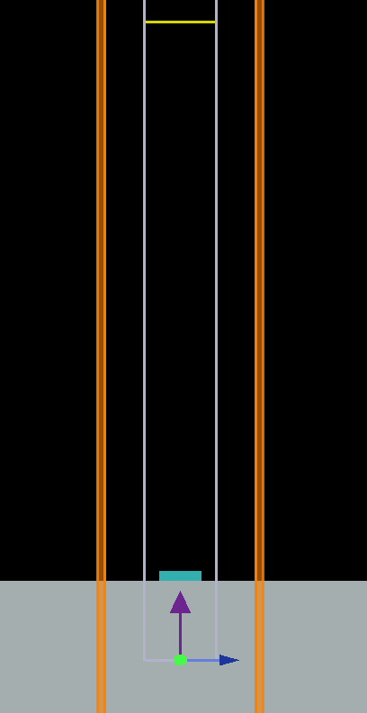

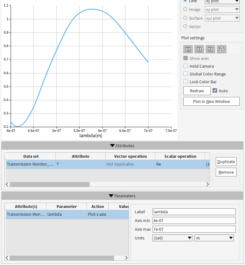

      Hi, I am running 2D FDTD simulation using TFSF source for finding the transmission. Is it possible to direcly find transmission  using the TFSF similar to using Plane wave source? In TFSF source where should I place the monitor for finding the transmission?  Sometimes the transmission goes beyond 100%. If it is a normalization problem then how to normalized the source correctly in TFSF source?

      Thank you for your reply. I need to find the transmission using the TFSF source. However, the link that you have given it calculates the sigma by normalizing it with the source intensity.
      Transmission is calulated in Lumerical as:
      So, my question is how to normalize the transmission using the source intensity since transmission is a dimensionless quantity.
      Or, is there any way to calculate the transmission using the TFSF source?
