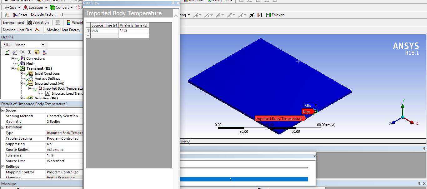

      Dear fellows,
       When importing body temperature to structural analysis, only portion before 1 second is being imported. Whole data is not being imported due to which stresses, deformations are not being calculated for the whole analysis.
      Does anybody know what to do in the analysis?
      Regards

    • Hassaan123
      Hi Kremella,
      Thanks for your response.
      I have done transient thermal analysis in workbench, I want to export the body temperatures retrieved to do the structural analysis of the welding done. Ansys is transferring when I create structural analysis but this load is only transferring at some part (e.g. 1 sec) but I want to know the stresses generated during whole of the analysis.
      Transient thermal analysis (moving heat source b/w two thin plates)
      Structural analysis (Imported body temperature)
      Analyses in workbench
