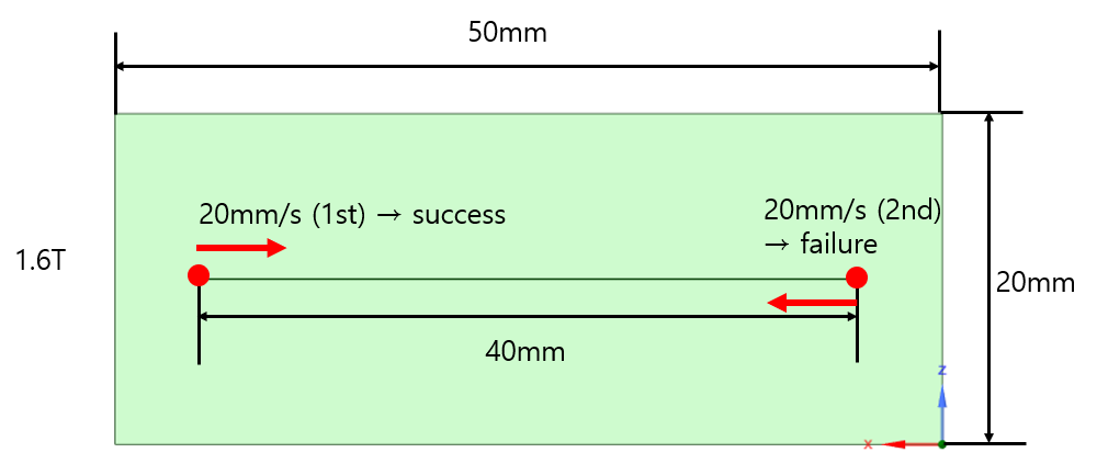

      Question 1. When using 2 Moving Heat Flux at the same time, only 1 can be used.
      It doesn't make any sense. I'm not sure why

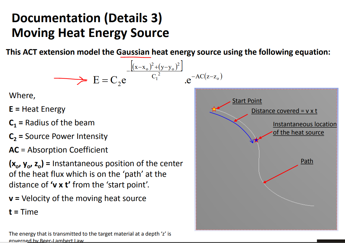

      Question 3. I heard that the heat source of the moving heat source is Gaussian, is that correct?
      Question 4. Can I put the value of 20mm/s as a -value to reverse the direction of the moving heat source? If not, please tell me how to specify directionality
      please tell me as detail as possible
