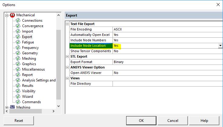

      But I work in Transient Thermal and I can only link Transient Thermal Solution to CFD-post (Results) (automatic transfer), but in this case I can't get temperature field for body, which is a part of assembly (only for whole domen or assembly (I need only for only one body). And when I export data in Transient Thermal, (for example, in .txt or .xls) I get only node number and temperture in this node. But I need coordinate (not node number) - x,y,z - and temperature in this coordinate.
    • Bhargava Sista
      Katya,
      In Mechanical, go to Tools > Options > Export and set the option for "Include Node Location" to Yes. Now when you export the body temperatures to a text file, the nodal coordinates are included along with the temperature.
    • user deleted
      Thank you!
