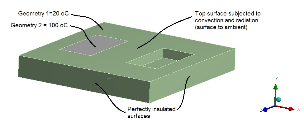

      I am trying to simulate the temperature effect of two bonded bodies, each at different temperatures. Body 1 is at 20 degrees Celsius and Body 2 is at 100 degrees Celsius. Body 1 is the cavity with a hole in the middle where body 2 is assembled and bonded. I run the simulation for 480 seconds. The heat in the model is transferred by conduction. Convection is applied at the top surfaces of both bodies and the boundaries of body 1 that contains body 2. I have experimentally run also this arrangement, so I have points to validate the model.
      The problem that I have with the simulation results is that the temperature in the boundary increases very rapidly and this does not correspond to the reality. I have attached an example.

      3d sketch
      Hello there,
      Thank you for your reply. I am using Ansys Workbench, steady state analysis in the beginning to apply temperatures to the two bodies and then transient analysis to apply convection and radiation to ambient applied at the top surface of the 3d assembly geometry. All the other surfaces are perfectly insulated. Please see attached sketch.

      5. Convection and radiation is applied at the top surface of the geometry assembly shown in my last figure. Emissivity for radiation to ambient is equal to 0.967 with ambient temperature set at 21.5C as in the whole simulation model. Film coefficient value for convection is chosen from Ansys itself values (Stagnant Air - simplified Case).

      2) In order to start evaluating the transient solution, Fluent need to understand the temperature condition you have for two bodies at time = 0.
      • Body 1: You need to patch T1 (20 C) to body 1 after you initialize the solution. This means you are setting up 20C temperature to whole volume of body at t=0.
      • Body 2: If I understood correctly, looks like you have a constant temperature boundary condition at six faces of the box (temp do not change with time at faces). These faces are the source of heat generation. Means produced heat will get transferred from these faces to body 1 (out) and 2 (internally) both through conduction. Is that right? If yes, what is the initial temperature (at t=0) body 2 is suppose to have? You could patch that as well.
      • How to patch: Initialize the case then go to patch and provide the temperature that two bodies have at t=0. After that before iteration, you could actually check the temperature contour to understand whether solver has take correction BCs.
