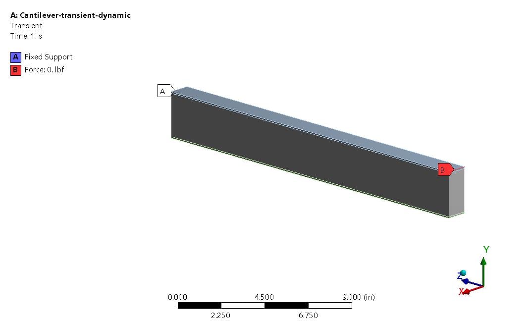

Secondly, the acceleration vs time is the output of the free end of the cantilever beam. I defined a ramp force at the free end of cantilever beam and the other end is fixed.

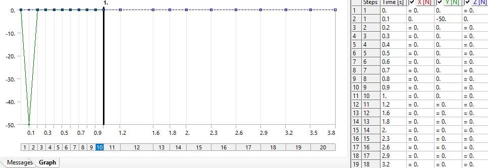

The force-time history i assumed to be ramp (assumed) in the ansys and i have attached the picture or it can also be impulse like during experiment when striking the end of the cantilever beam with hammer. After this analysis i got the response of acceleration vs time in the y-direction. The force is shown in the picture attached.

You can use this force-time history as input in a Transient Structural and observe the result.
This input force-time history has a very low frequency. A pulse width of 0.1 seconds has a frequency of 10 Hz. If your cantilever beam has a high natural frequency, like 100 Hz or higher, then this input force-time history will only produce a quasi-static response. In other words, the tip deformation will follow the force, x = F/k, which is not very interesting.
If the cantilever has a very low frequency, like 1 Hz, then you will get some dynamic response from this force-time history.
Peter

peteroznewman
SubscriberAdeel,
If what you want is to have a force impact on the tip of the cantilever, then the reciprocal of the pulse width time has to be smaller than the frequency you are trying to excite.
In the example of a pulse width from your force-time history above, that is a 10 Hz frequency. Apply that to a cantilever where the first natural frequency is 100 Hz and the tip will just follow the force down and up and there will be no oscillation after. Apply that to a cantilever where the first natural frequency is 1 Hz, then you will see some oscillations of that first mode.
One of the lower modes will be a twisting mode, but if your force is symmetric across the width, it won't excite the twisting mode.

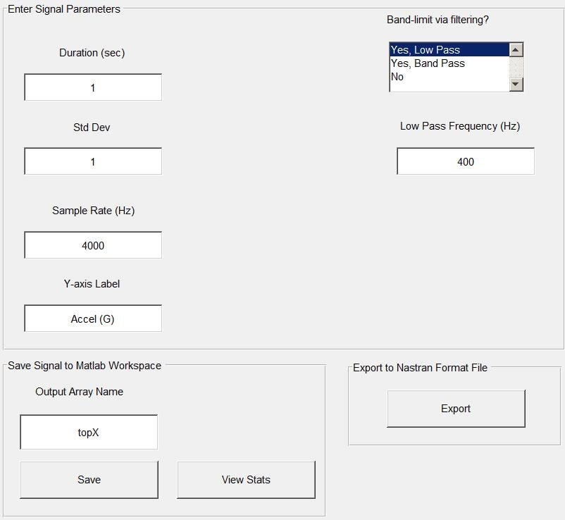

I like Jason's idea of using different models to apply random vibration force at different locations to identify resonant frequencies in your cantilever.
For example, if you slice your model at three planes, 25%, 50% and 75% of the length, you will have four models. On each model you will apply a force-time history.
Your cantilever looks like it will go sideways as well as vertically and it will probably twist also.

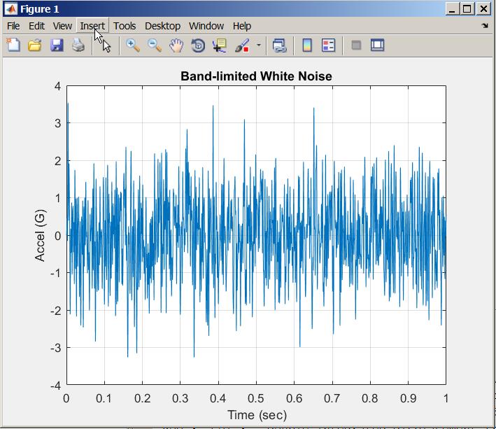

Use the vibrationdata GUI in matlab to Generate Signal and make four random vibration force-time histories that have X and Y components (let's ignore Z for now) for two force inputs. Apply one force to the bottom of the sandwich and the second force to the top of the sandwich on one of the four locations.
Pick four vertices along the top and four vertices along the bottom of the cantilever and output X and Y displacement-time history and use vibrationdata in matlab to look at the FFT or the PSD of those 16 signals.
From the Modal analysis, there is a mode at 316 Hz, but you only asked for 6 modes. There are higher modes, but do you want to find them?
Sampling Frequency
In order to see a 316 Hz frequency, you need to sample at a minimum 2 times or 632 Hz. I recommend you sample much higher than that, say at 1000 Hz which is a 1e-3 second sampling. Under Analysis Settings, you only need one step under Step Controls but you must set the Maximum Time Step to 1e-3 seconds.
In order to drive a 316 Hz response by a time-history input, the minimum sampling frequency is 10 times or higher. In matlab, Generate Signal, and select white noise with a Low-Pass cutoff of 400 Hz. use a sampling frequency of 4000 Hz to generate a 1 second long time-history.
If you want a larger input, you can type in a larger value for Std Dev.

Subscriberok Thanks peter for your detail explanation, I tried the first step as suggested by Jason and you and created 4 different force-time history. I just changed the sampling frequency in the vibrationdata gui and got 4 plots. Here is one of the force-time history plot. Please check it, is it ok? The rest of the parameters are same as in the picture you posted yesterday.

SubscriberLooks good. Do all four white noise variables have the same sampling frequency? You want them to have the same number of rows (4000) because you want to export them into Excel to create the ANSYS input which takes one of the variables that has two columns: time and accel then add the accel column from the other variable and then fill the fourth column with zeros to make a file that will look like this:
0.00025Â -0.742235Â 1.243492Â 0.0
0.00050Â -0.104845Â 0.945108Â 0.0
0.00075Â etc.
That will be the Force input file for the force applied to the top edge of the beam. Repeat with the other two matlab variables to make a Force input file for the force applied to the bottom edge of the beam.
You might need to scale these number up by multiplying them by 10 or 100, or pasting them in using different units if, after running a Transient solution, the response at the 16 points is too small.
It will be quicker to duplicate this model and re-scope the forces to the next station since pasting in 4000 rows of data might take some time.

No, i defined the sampling frequency different like:
1. Force1=1000Hz, Force2=2000Hz, Force3=3000Hz, Force4=4000Hz
2. About the following part (columns), i didn't understand. Can you please give a simple example

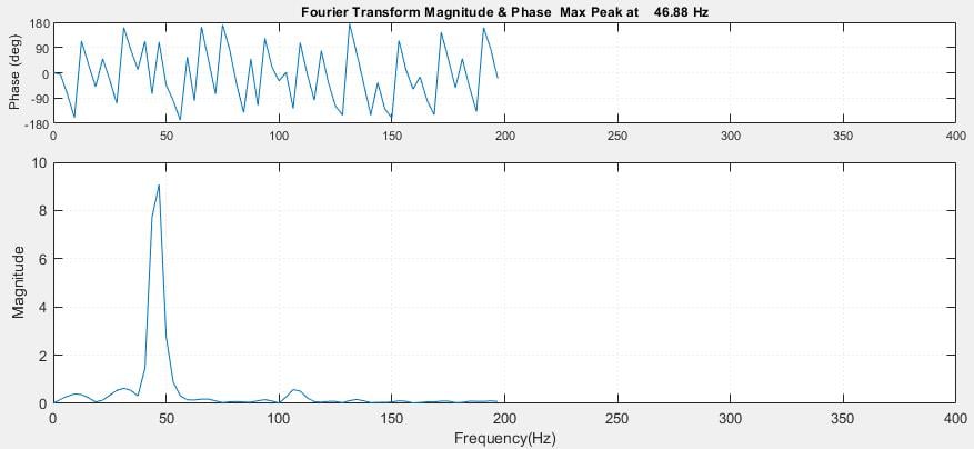

FFT plot looks good. If you close that Figure, the one behind it is the one I use as it does't show the Phase plot at the top.
1. Make all four matlab white noise variables have the same sampling frequency. Just hit Calculate to get a new random sample.
2. Double click on the matlab variable Force1, you will see it has two columns: time and acceleration. If you copy and paste the data from matlab to Excel, you will have two columns. Now double click on the matlab variable Force2, it also has two columns, but column 1 is identical to column 1 from Force1. You only need column 2 from Force2. Copy column 2 from Force2 and paste it into column C in Excel. Finally type a 0.0 into cell D1 in Excel and copy and paste that down through all 4001 rows. Now you will have in Excel four columns: time, accelX, accelY, accelZ that is suitable for pasting into ANSYS Force-time history.

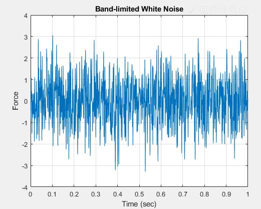

Make sure your time period is a lot longer to have a finer frequency resolution. [ frequency resolution = sampling frequency / block size ].
For the same sampling frequency in the most recent plot, I would suggest you increase the time period by a factor of 10. Plot your y-axis in log scale to better distinguish signal from noise.

I have generated 4 force-time history with same sampling frequency as you mentioned in the last post and also prepared the excel sheel. Now i am trying to input this into Ansys but  I have student version Ansys, so will it perform the computation of 4000 data points?... I mean there is no restriction on time taken to solve the model?

sk_cheah
SubscriberAdeel,
I meant to suggest you increase your total simulation time while maintaining your time step. If you had it at 1s before, increase it to 10s.Â
