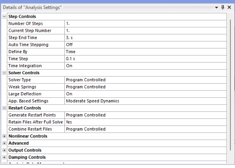

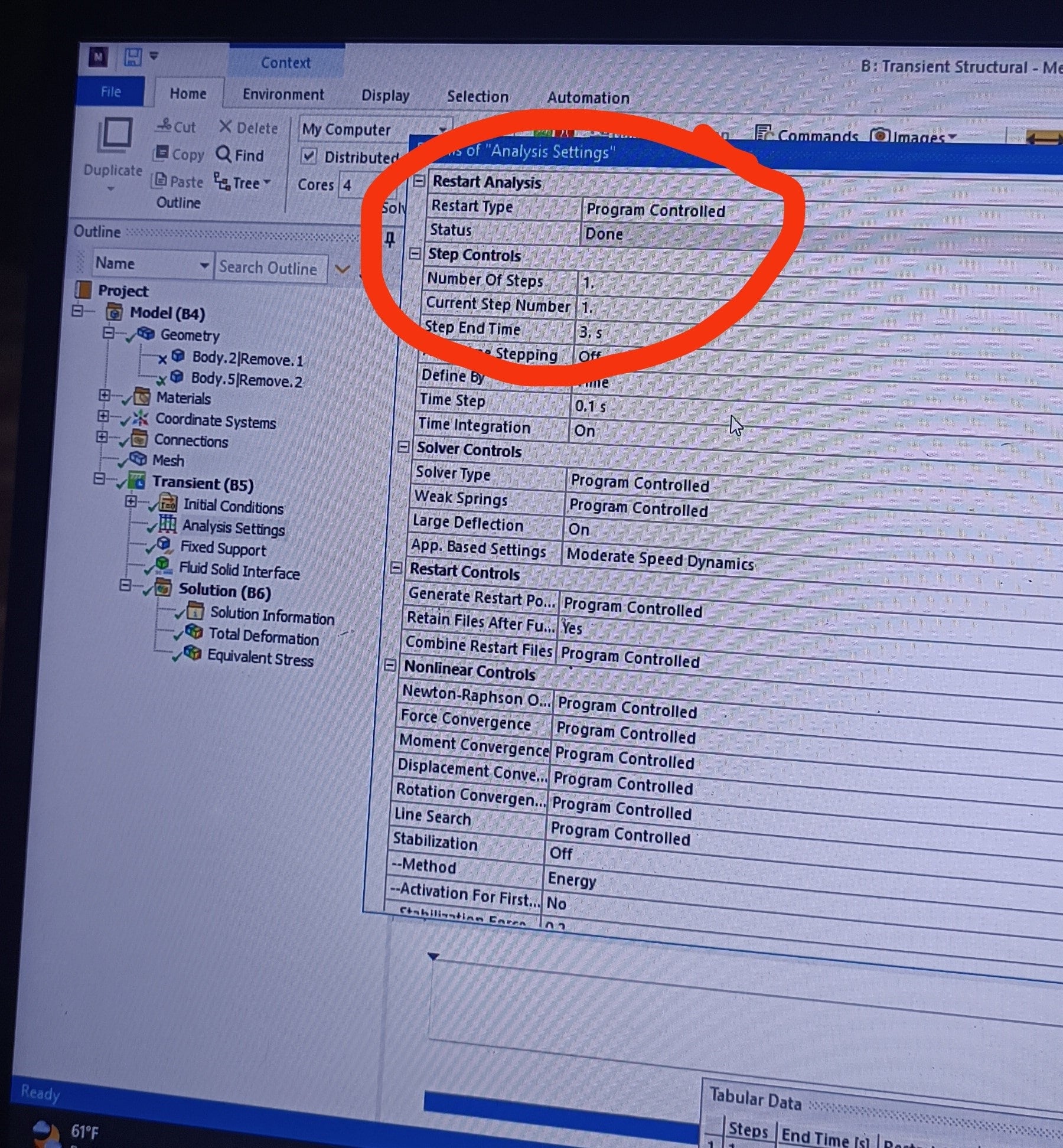

    • Amrit Kumar Yadav
      How to change the restart analysis like restart type in programme control in transient structure

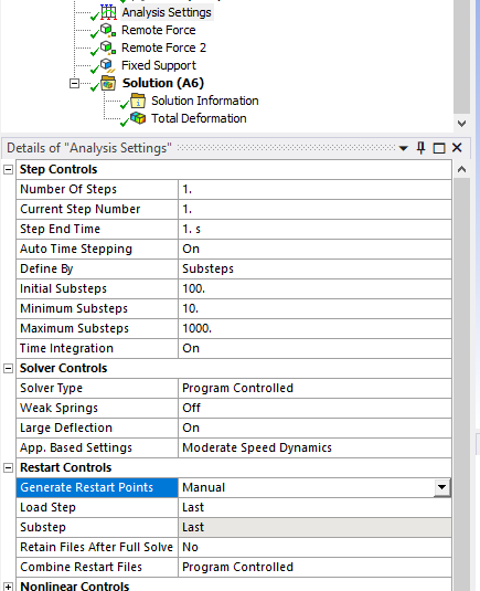

    • Nanda
      Hello Amrit,
      You need specify, generate retstart points to manual. Then you can chose from which load step you want to restart the analysis.
      Have a look at this Ansys help link, which gives you a detailed insights.
      Restart Controls (ansys.com)
      Using Solution Restarts (ansys.com)
      Nanda.
