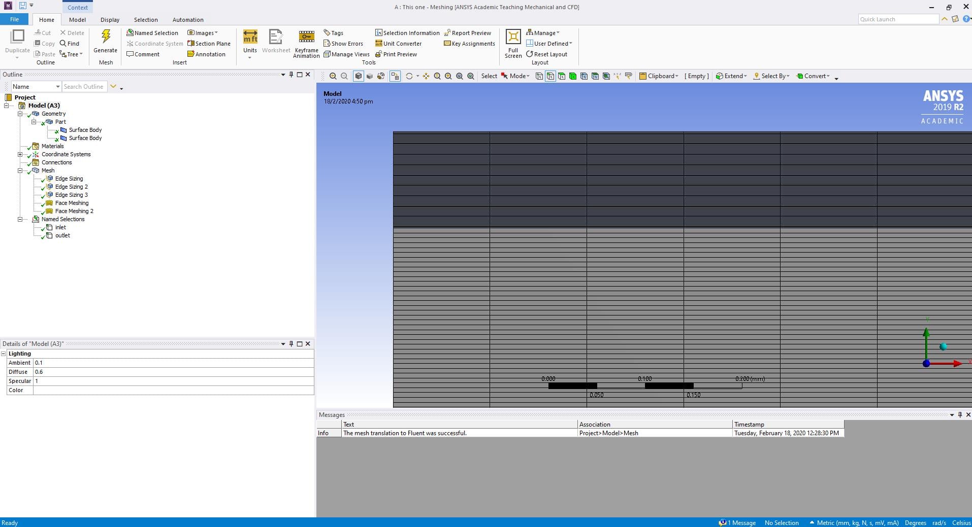

      Below is the 2D planer model i built. Bottom is solid which has initial temperature of 312K and above is flow zone which has initial temperature of 300K. it's length is 100mm.
      This is mesh. along the length the numeber of division is 1000. height is divided into 100 element for each solid and fluid part.

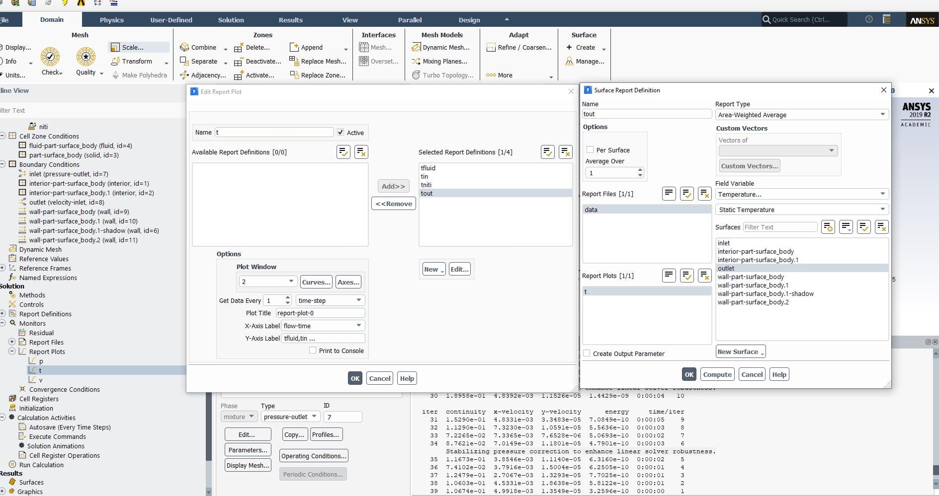

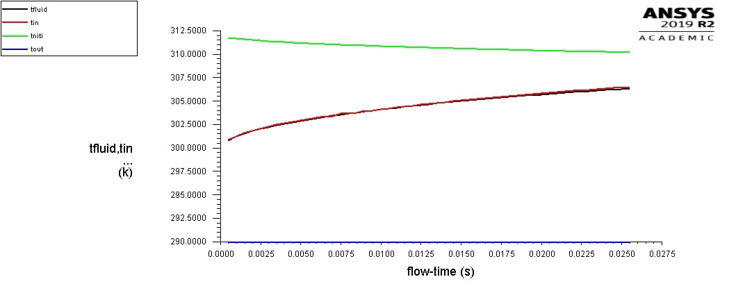

      This is how details of outlet temperature plot
      area weighted average at the outlet boundary.

      The result show as presented below:

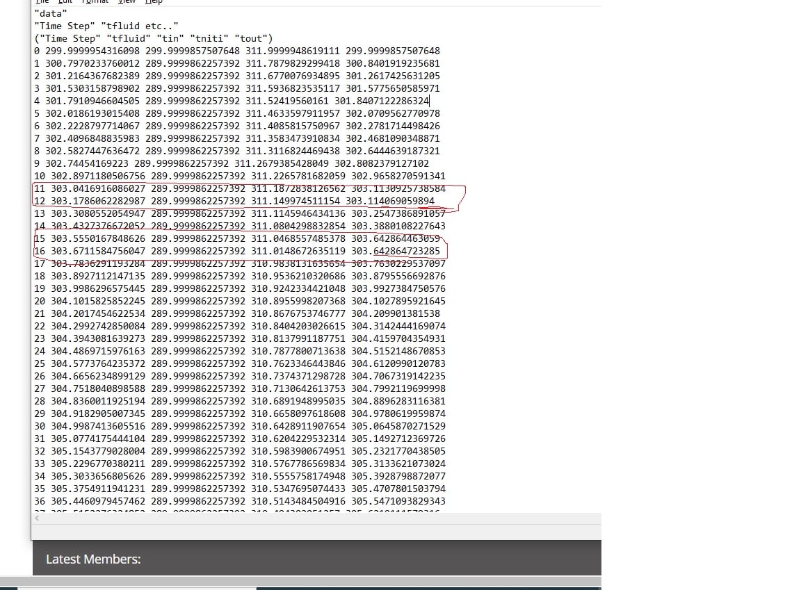

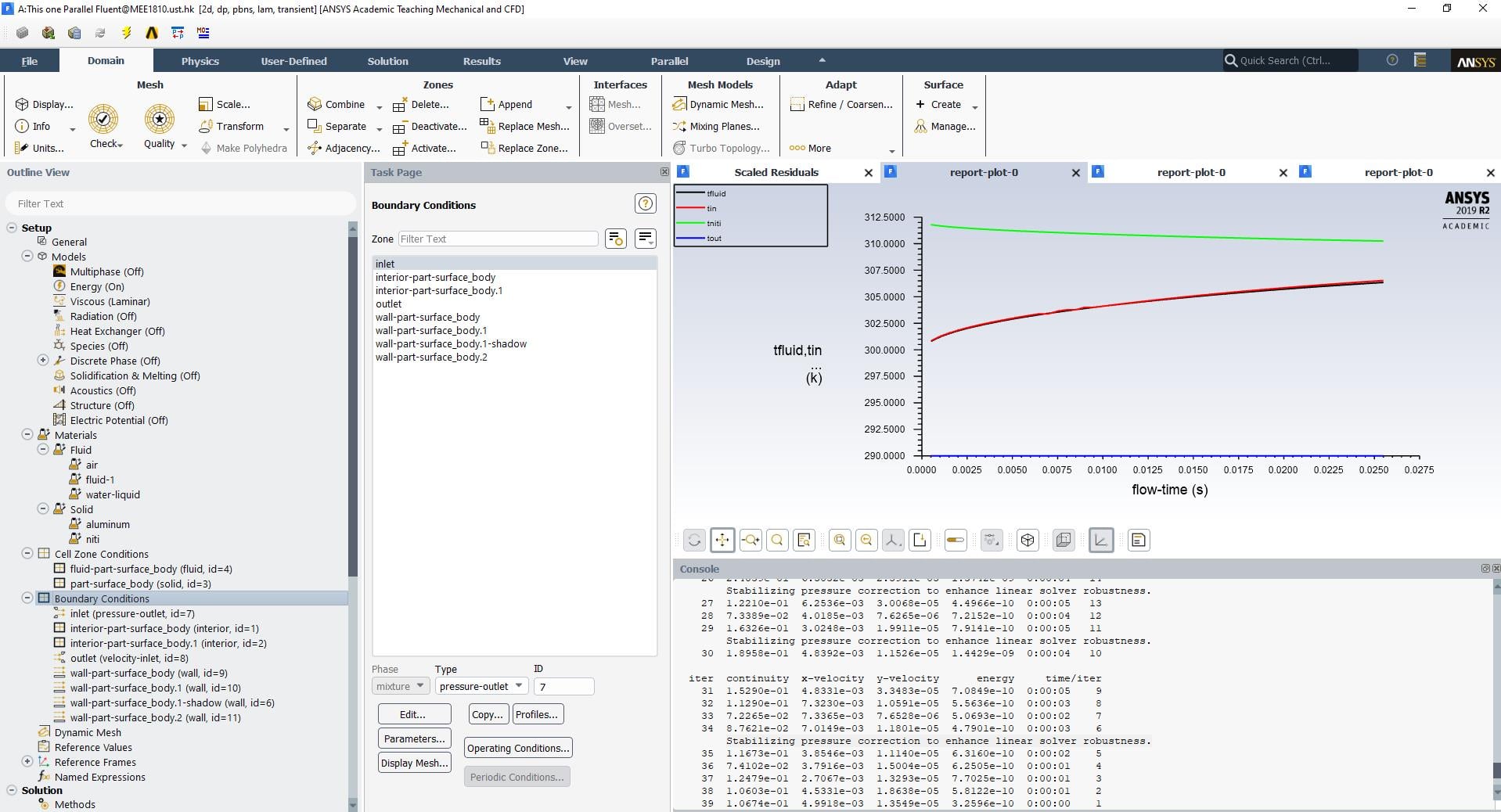

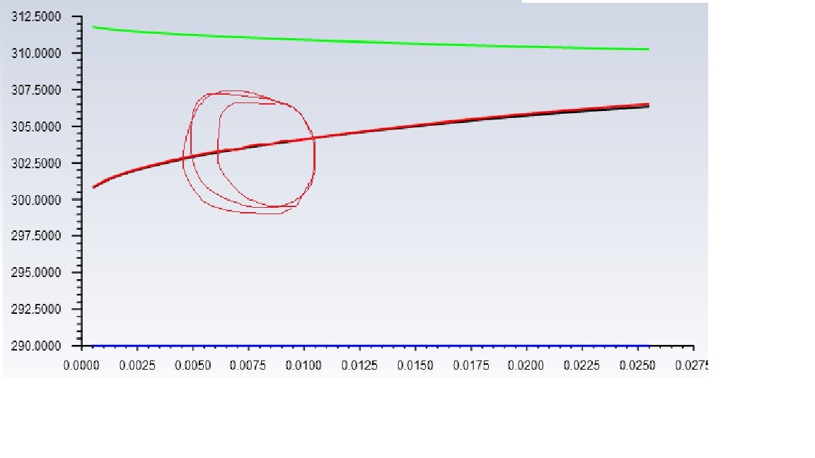

      The temperature gradually increases but at around 0.0075 and 0.0085, the red line makes two horizontal lines which represent constant temperature at those two time slots.

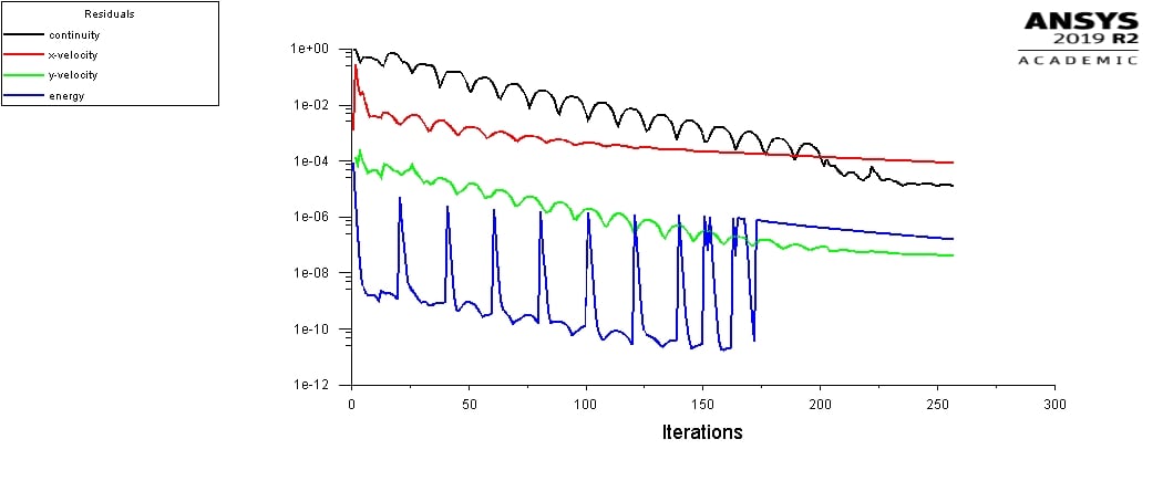

      This is my residual plot

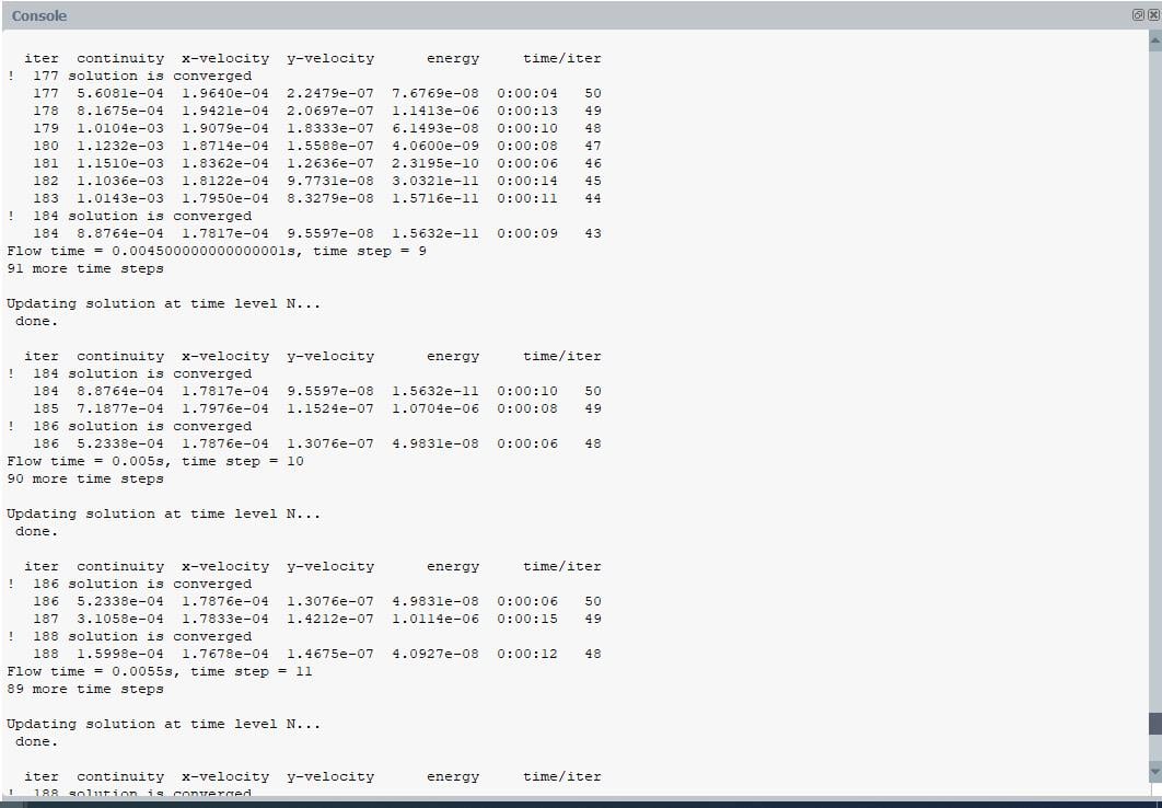

      Why does the temperature line does not increase gradually but make two flat sections?. I have looked a the temperature value at the time step where this happens. the values gradually increases but i found for a two time steps the temperature was constant. this is shown as flat section in the plot. Is there anyone who can help with this problem?
    • Keyur Kanade
      from the image it looks like it is not converging each time step. make sure that for each time step it converges. reduce the time step further and increase no. of iterations per time step to say 50.

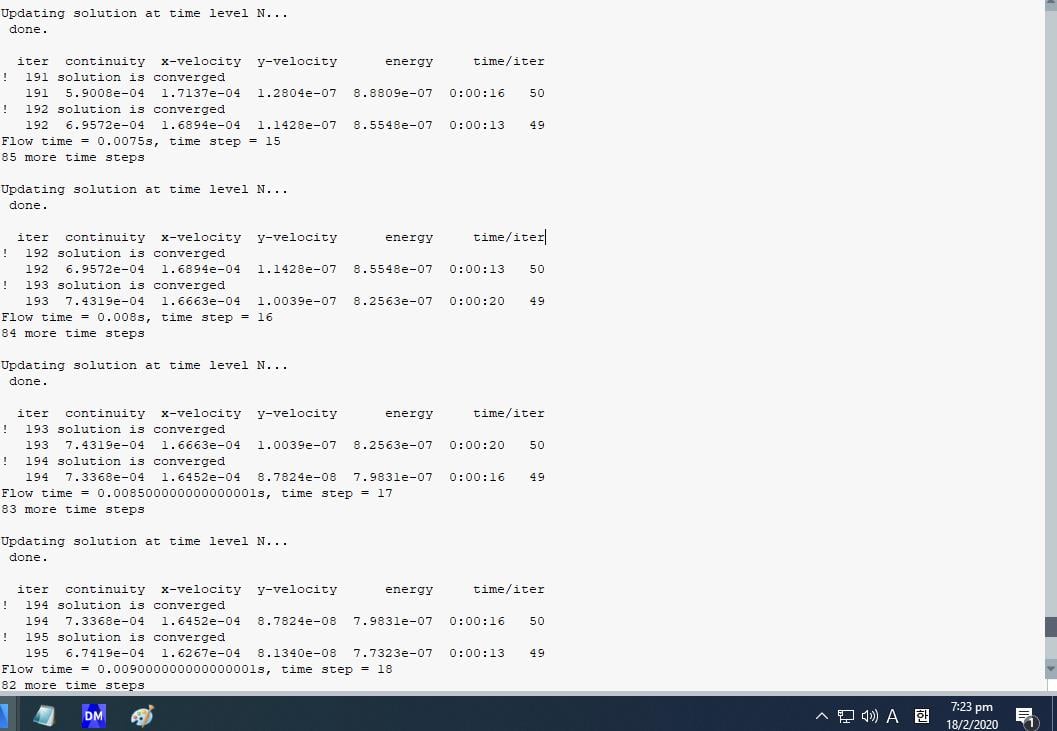

      However, temperature increase stop at the time step of 11-12 and 15-16  as shown in the output data.  And int the console is shows that at these time steps it converges.....
      Look at the flow field and monitor definition together and not in isolation. Does something else happen in the flow at those steps? Ie separation, changes in angle etc. Remember you're moving from an initial condition to the transient (time changing) result.
    • jhur
      Hi rwoolhou.
      Thank you for your advice. I looked at the flow field as well but I dont see any significant effect occur at those steps.....
    • DrAmine
      Enforce Fluent to run three iterations every time step by increasing report interval to 3.
      Other hint: mass weighted average of temperature at boundaries other than wall.
