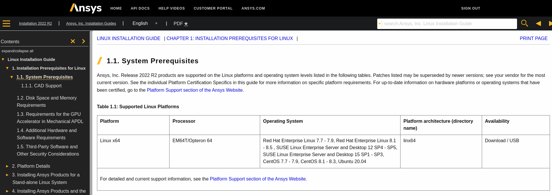

      Although it might not be related, your OS is not on the list of supported operating systems (see 1.1. System Prerequisites in the Ansys Installation Guide),
      One possible reason for the error could be related to CEL expressions.  During the run, CEL expressions are evaluated using integration point information.  When writing backups or the final res file, expressions are evaluated using nodal information which can be slightly different.  It could be that a CEL expression is generating an error (i.e. divide-by-zero, invalid exponentiation) related to this.  Running the model in serial can help verify if this is the case and identify the expression causing the issue.
    • brian.tang
      Ubuntu 20.04LTS is on the supported list for 2022R2 (see https://ansyshelp.ansys.com/account/secured?returnurl=/Views/Secured/corp/v222/en/installation/unix_sysprereqs.html and https://www.ansys.com/content/dam/it-solutions/platform-support/ansys-2022r2-platform-support-by-application-product.pdf). Support for Ubuntu 20.04 was added in Ansys 2022R2, and this is literally the reason why I am running this particular distro and version of Linux.

      Hi Brian,
      My apologies regarding the OS - I didn't see the last one (Ubuntu 20.04) in the list in the Installation Guide.
